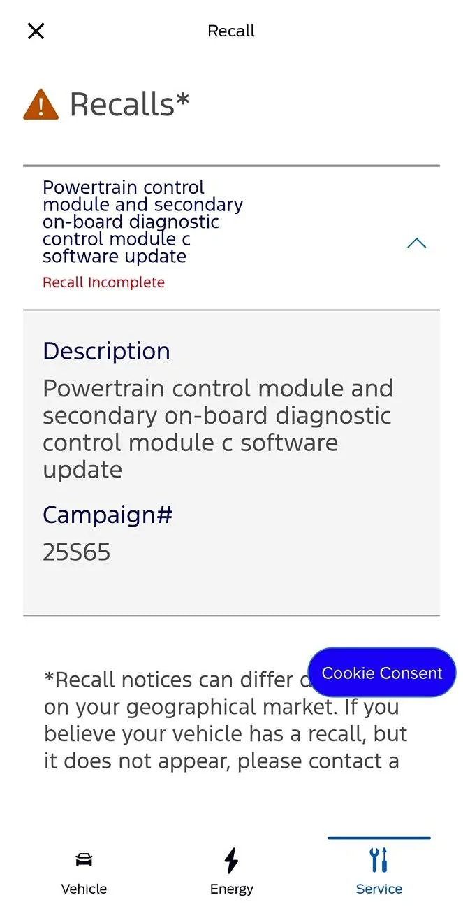

I got this message in my app. Called the dealer and they said it's only applicable if my engine light comes on. I told them that it might be the 12V issue and they said it isn't, even though when I google the campaign number, it says it is. Do I have to worry about it for now?

The fix is only available for 2025 models right now. But that’s in the US, not sure about Canada.
Just wait until you get a letter telling you to take it in.

Your dealer is wrong on both counts. Like mentioned, this IS the 12V recall - but there's nothing you can do yet until the fix for 21-24s is ready. Likewise, this is a recall - so you need to have this completed regardless of if it is currently a problem for you (or if a light comes on).
