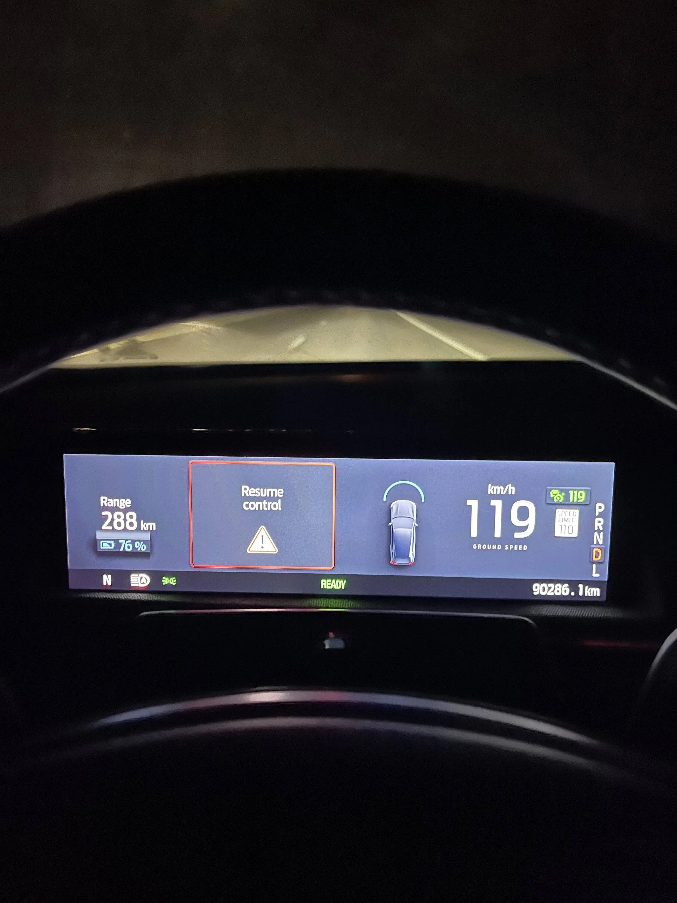

decided to use BlueCruise since I hadn’t in a week or so.
it kept kicking off and restarting. Once it flashed up Resume Control. Which I did. The warning disappeared.
A little later same warning on the screen plus the warning sound. Problem was that it wouldn’t shut off.
headed for the next exit and a gas station in case the car shutdown.
To add to my fun. That exit had a Police ride check. The officer looked at my dash, heard the noise. Asked if I had been drinking. I said no. Off I went.
got to the gas station.
Applied the when in doubt reboot approach.
Car came back to normal with no warning sounds. Made it home with no further issues.

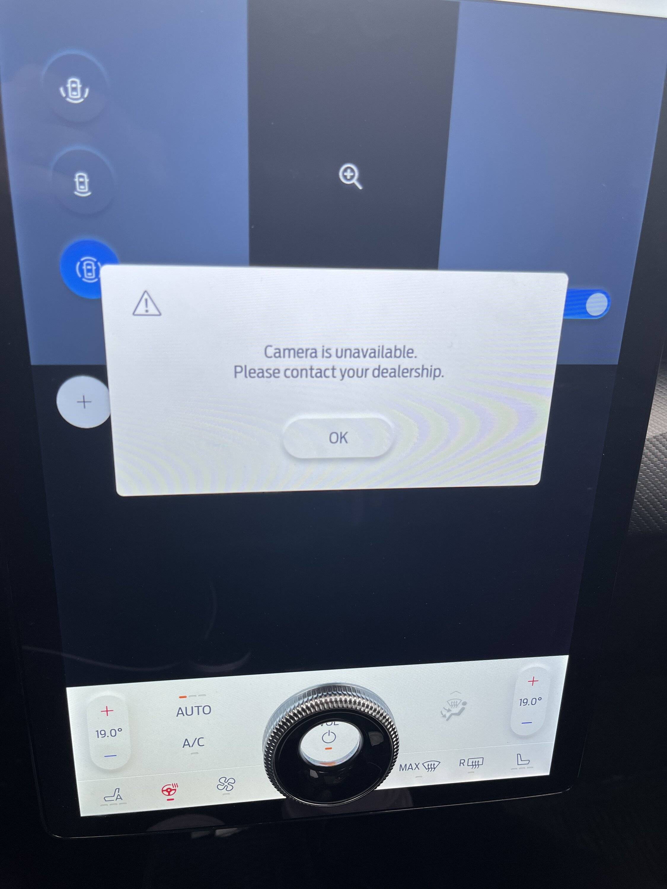

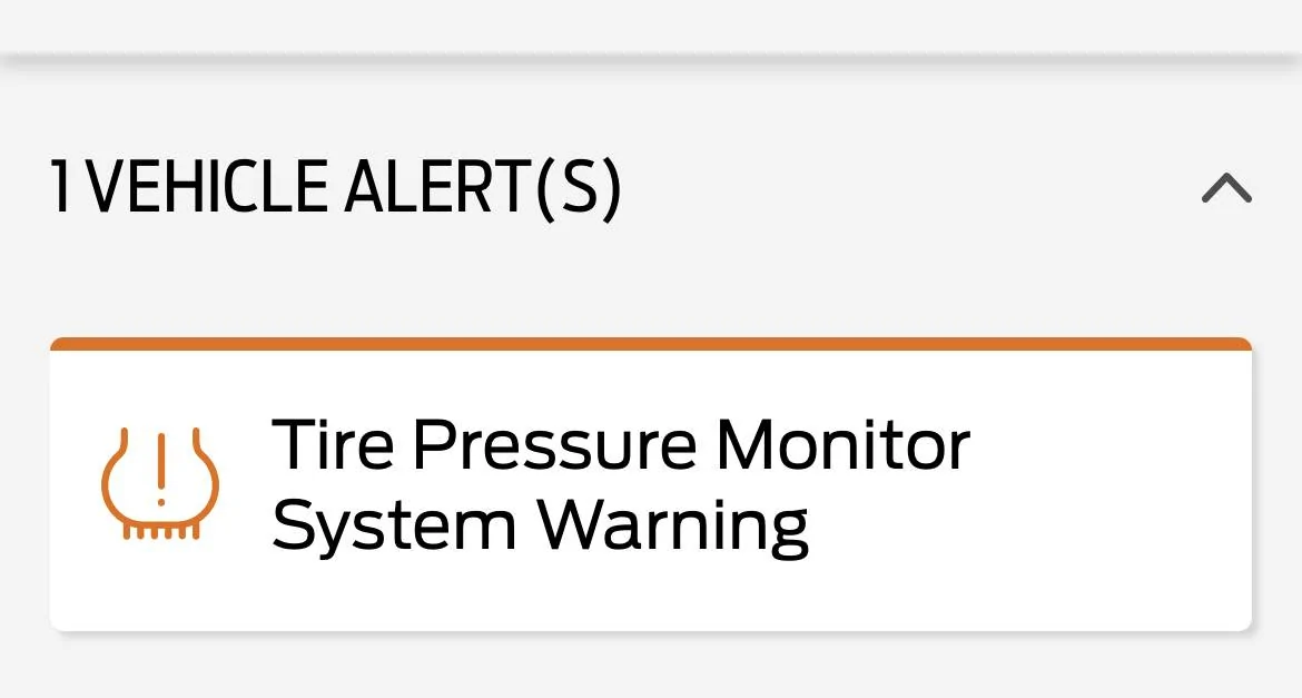

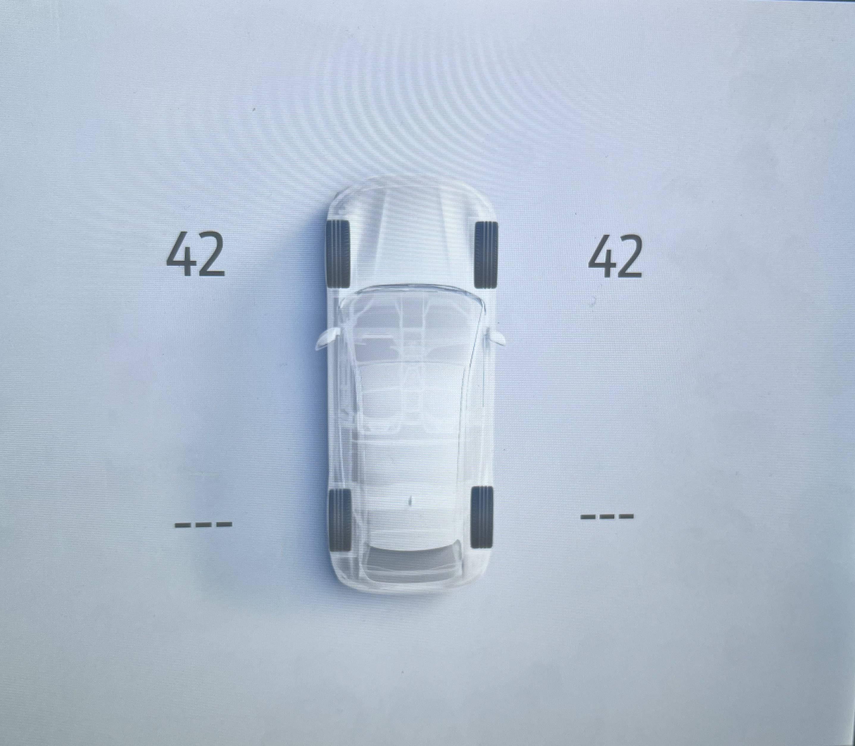

Not sure if related. But a few days before I got a TPMS warning and the rear wheels showed a fault. This has happened before. When reversing into the garage my rear camera also showed a fault.
For that problem I used the drive it until it fixes it self approach. Which after a couple of start stops of the car it did.

That's a bug I haven't seen for a while. So guessing you're way behind on software updates, you'll probably want to make an appointment.
