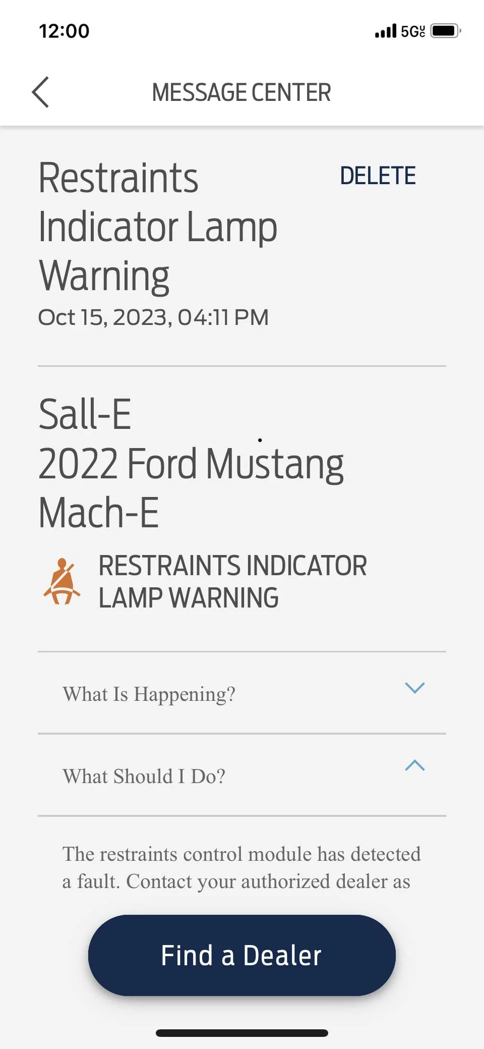

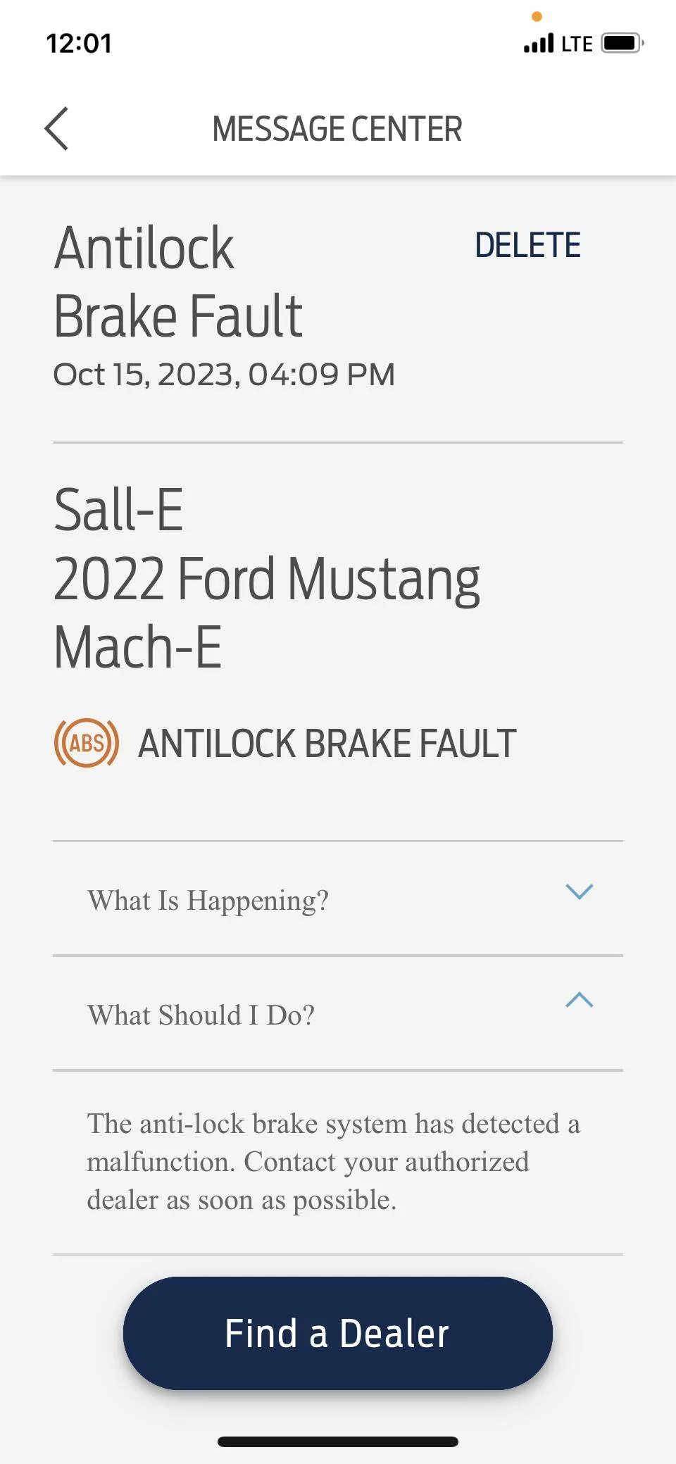

I noticed the instrument panel reboots sent a bunch of error messages
Ford Mustang Mach-E Small screen restarted several times IMG_1395
reboot caused a bunch of
Ford Mustang Mach-E Small screen restarted several times IMG_1396
errors
errors
Good morning! I would be glad to help you out with these error messages/screen concerns if you'd like. Just shoot us a PM with your VIN and dealer name/location, and I'll get right on it. To send a private message, just click on our username and select "Start Conversation".Thank you!
