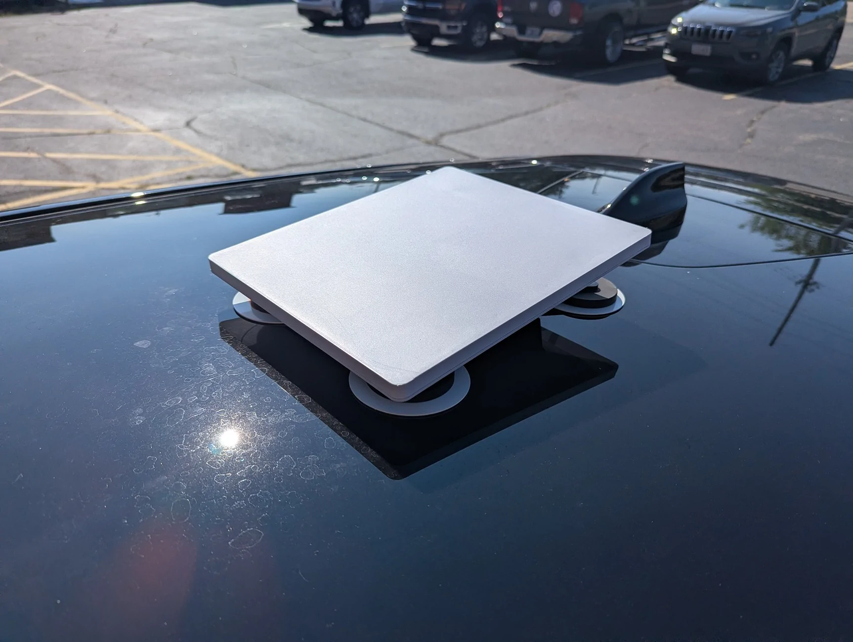

Finished install

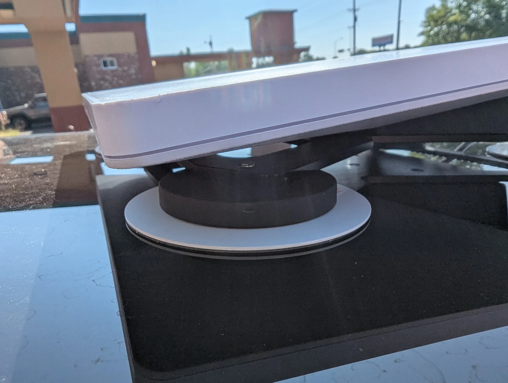

Close up of the adhesive mounts. They provide some tolerance to error if you place the antenna down slightly off.
I'd recommend first cleaning the roof really well, then placing the magnetic pads on the fully assembled mount, removing the film covering the adhesive and then slowly lowering the antenna into position. Once it's down, that's it, it's not moving again. A careful person and a heat gun would be needed to remove these metal pads if ever required. Kinematic constraint calls for the loosening of one of the magnetic rubber pads, or else the fixed position mount will not sit perfectly flat on the slightly curved roof. Once it's mounted, slide it laterally to remove and loosen one of the front pads a half turn (or so), so it can wobble. Carefully reinstall. Magnetic force propagates with 1/r^3 so it will really "snap" down and could break your top glass if you just drop it down. Slow and steady, provide ample reverse pre-loading of the mount when lowering it down.

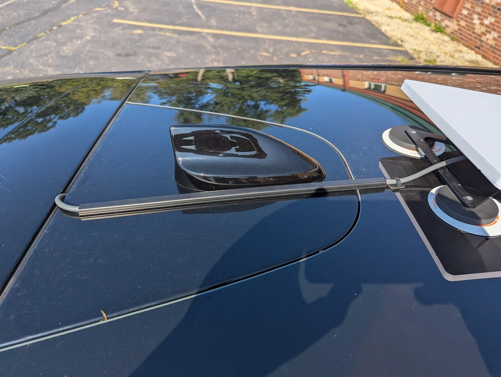

Cable guide / Cable hider

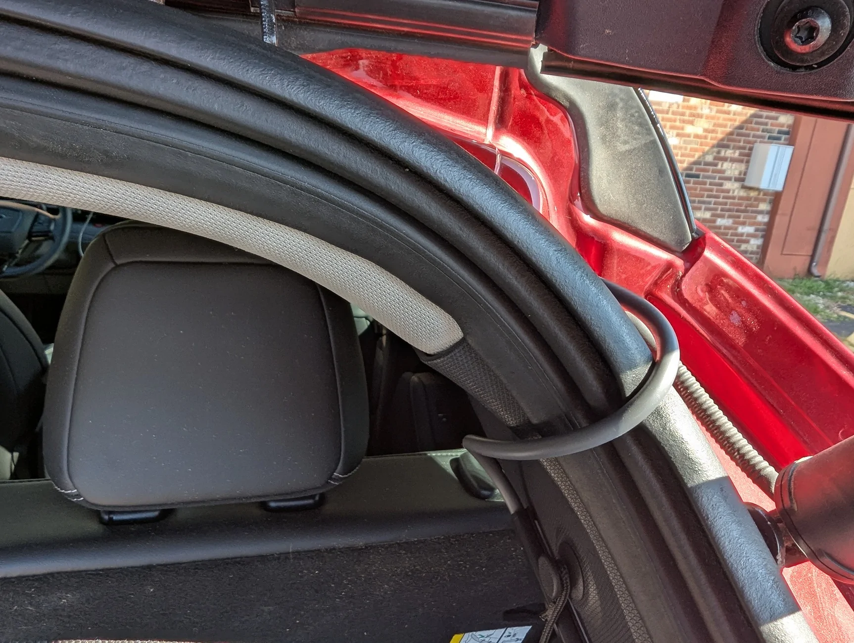

Cable insertion point into the hatchback area

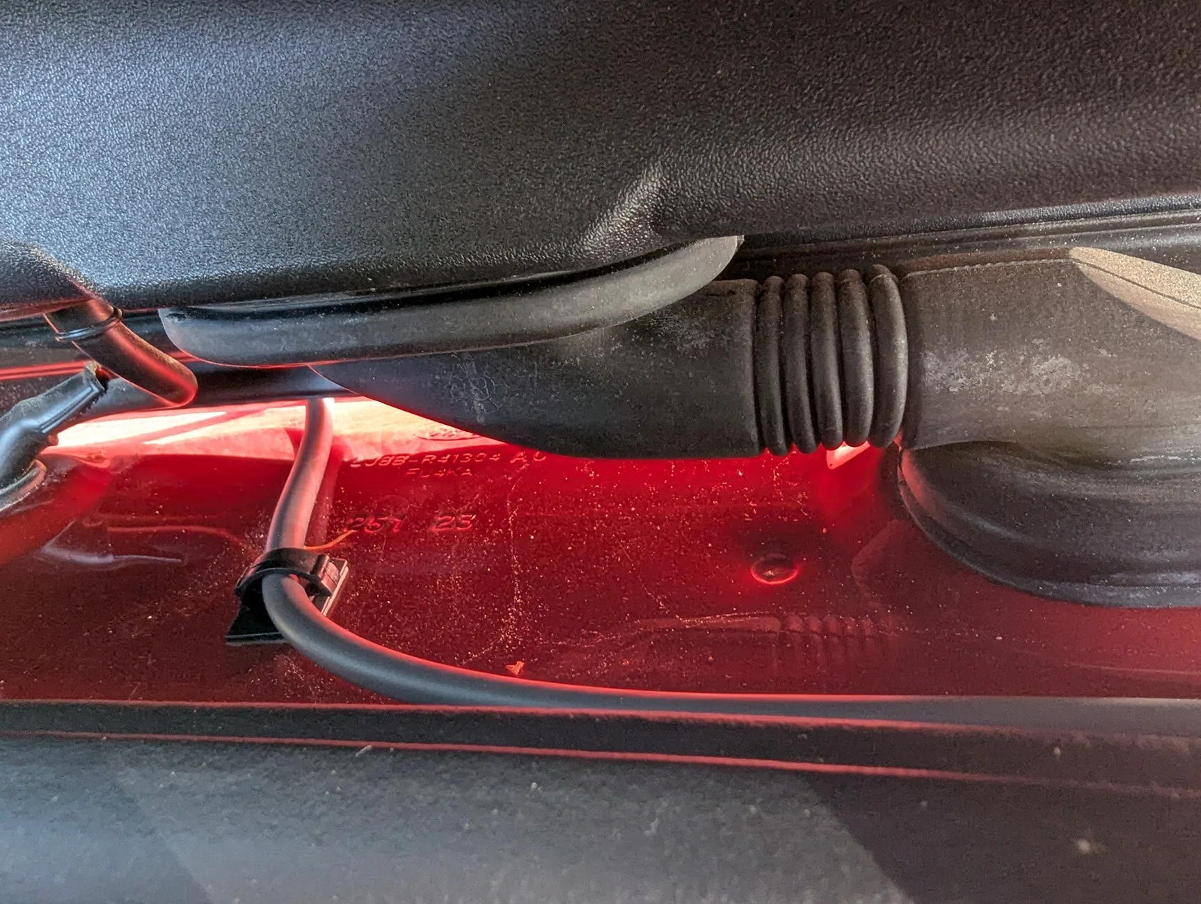

Cable insertion into the interior. No leaks.

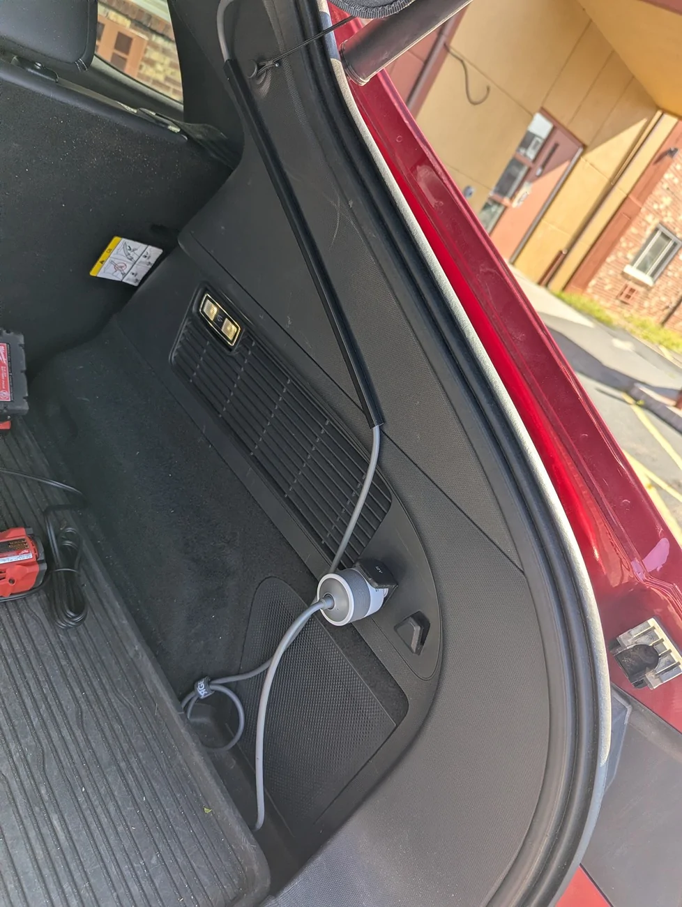

View of the power supply fed by another cable hider.
The cable is "almost" cinched by the hatchback, but after a month of openings and closings it appears completely undamaged. It makes a little frog sound, which was not expected, but acceptable.
