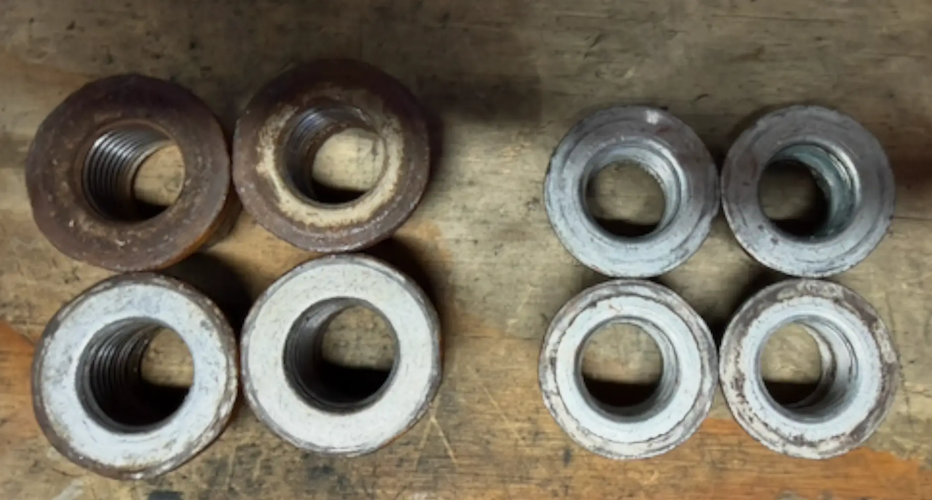

The source of the noise on both vehicles was loose and corroded axle nuts (also known as spline, spindle, or half-shaft nuts). The larger motors in these vehicles—front for the Lightning, rear for the Mach-E—put significant stress on these components.
Reference the attached file Axel nuts.png for a visual comparison:
  • Left side: Lightning nuts (heavy corrosion is visible on the top two).
  • Right side: Mach-E nuts (the bottom right pair are from the rear axle, which houses the more powerful motor).

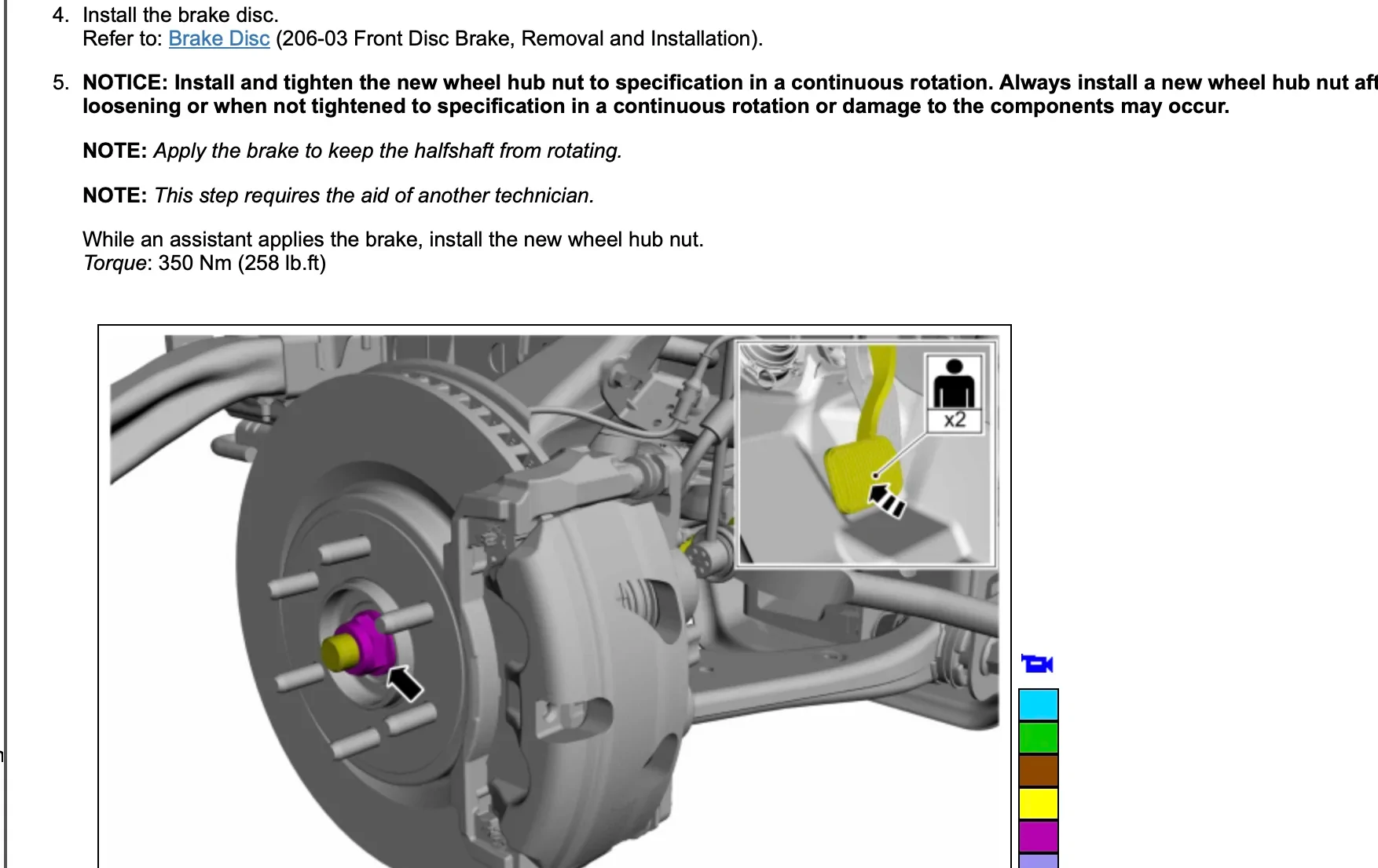

Following Ford's official service procedures (some details in the attached file Lightning Axel.png), the fix requires replacing the hardware.
  • Remove the old nuts and discard them.
  • Apply Loctite to the threads and install the new wheel hub nuts.
  • Critical step: Tighten the nuts using a torque wrench in one continuous rotation. Always install a new wheel hub nut after loosening or if not tightened to specification in a continuous rotation, otherwise damage to the components may occur. Do not use an impact gun; continuous rotation is required to generate the necessary friction. Applying the brake (for the front) and parking break for the rear will keep the halfshaft from rotating during this process.
Torque Specifications
  • 2023 Mustang Mach-E: 150 ft-lbs.
  • 2024 F-150 Lightning: 258 ft-lbs.
(above is for the F-150 Lightning)

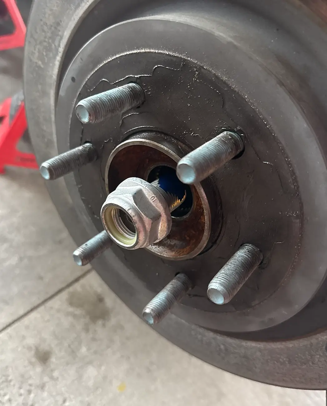

Just make sure you clean up the wheel hub surface that the back of the nut tightens down on - I didn't hear -- but did after this picture. Need to remove any corrosion to make sure the surface can grip enough. You can see the blue loctite on the thread.

that's my truck vs. the Mach-e -- but same idea! :). (in case someone counts the lug threads) ha ha. Also the Mach-e nuts don't have the plastic insert on the nut.
