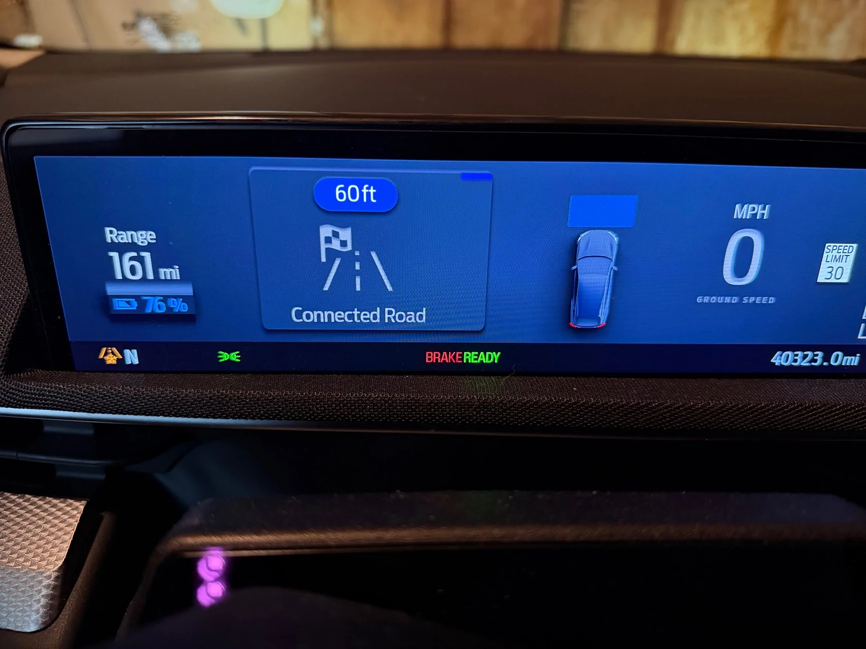

Ford Mustang Mach-E Stuck Connected Road Message - Restart APIM IMG_0856
Our 2023 MME was stuck displaying this message about a connected road in 60ft. Restarting the car didn’t help because the APIM stays alive for a few minutes, but restarting the APIM/center screen (volume down + right seek) got rid of it, so if you ever experience this issue, that’s how to get rid of it.
(posted for posterity because Google didn’t lead me to an answer)

Thanks. Is that a Navigation Screen?
Center screen was restarted, yes. Interestingly, car wasn’t navigating when it showed up, and we don’t have an active BlueCruise subscription, so no clue why it showed up.

You can also set a destination and cancel. No need to reboot. This bug has been with the car since day 1.
