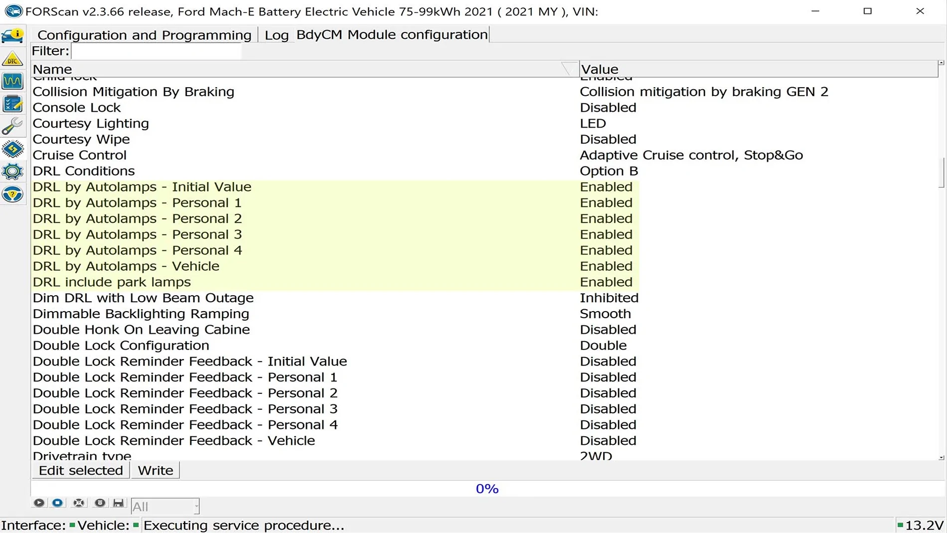

Be that as it may I, for one, will be using those tail lights. I say "will" because I just figured out how to enable those with the DRL, tested the change and
am happy to report that the solution is indeed found and is working.
In the BdyCM configuration I changed the highlighted section of the attached picture to the values depicted.
And that was it!
While I was there I did also enabled the "walk away lock" in the same fashion (for all persons). That worked a treat as well.
