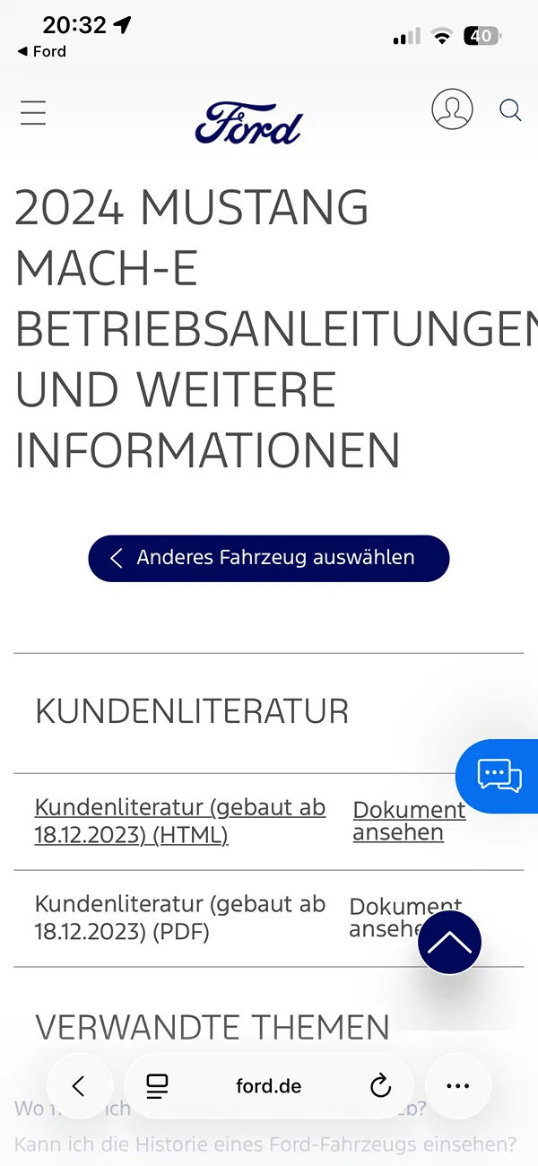

Hey i have a Screenshot of a 2024 usermanual beginning 18th dec 2023. That is the reason why I got confised. ( its in german but should be the same in english as it comes voa the link in the Ford pass app).

Look at your VIN. If the 10th digit is an R, it's a 2024. If it's a P it's a 2023. 😁🐩
