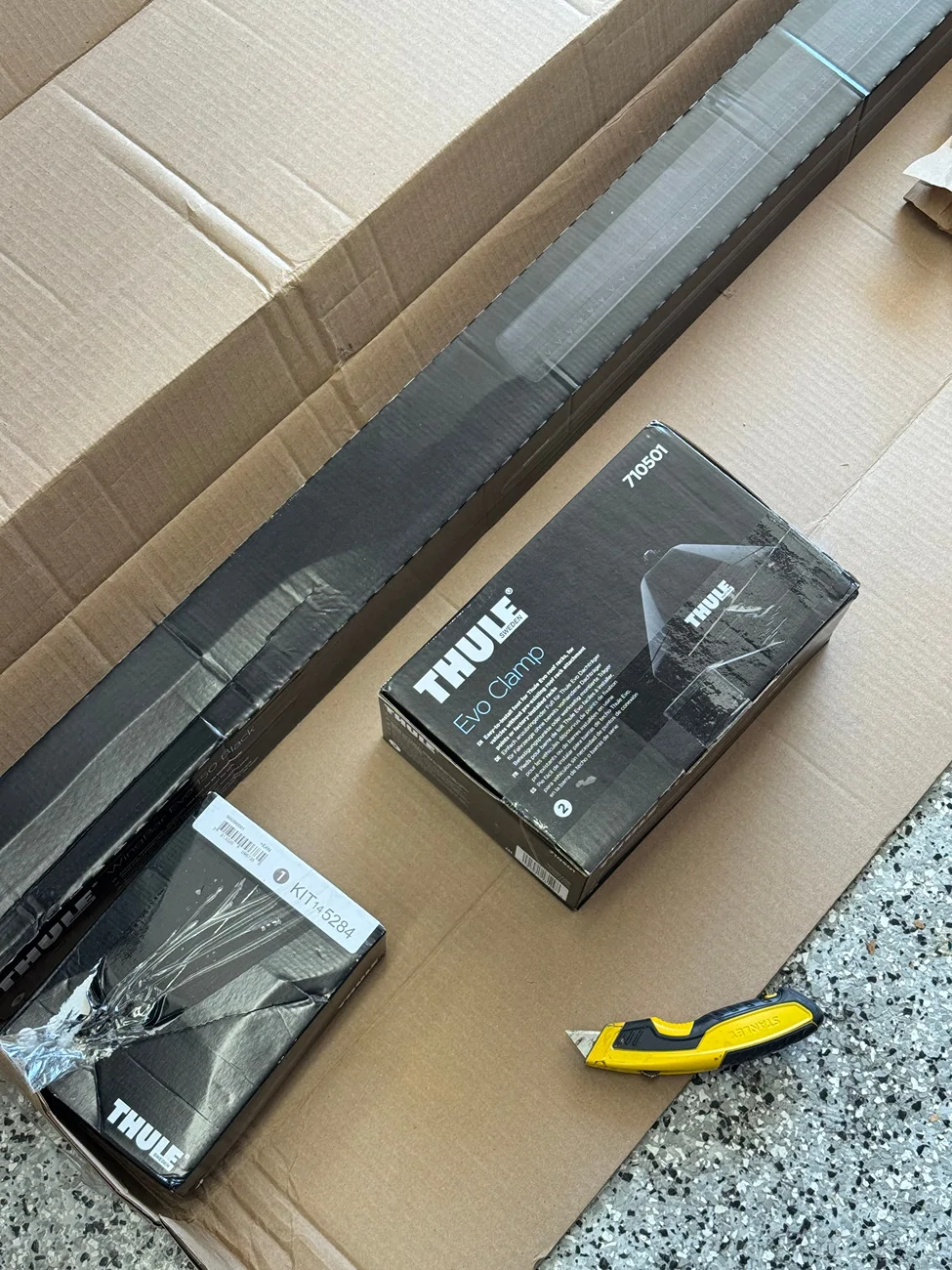

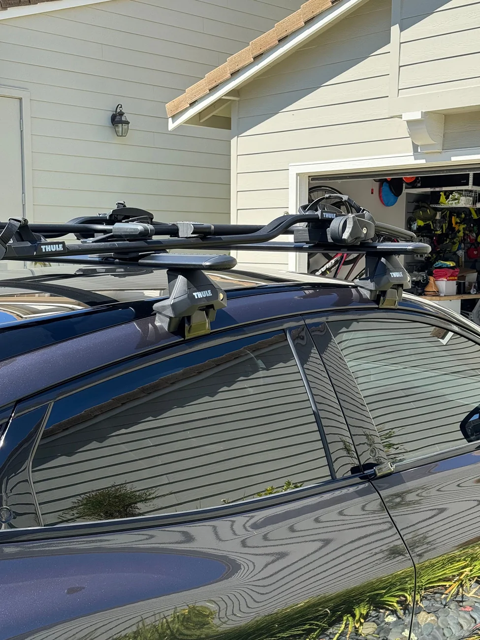

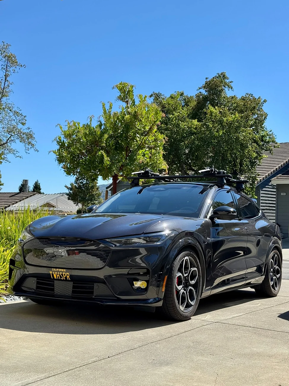

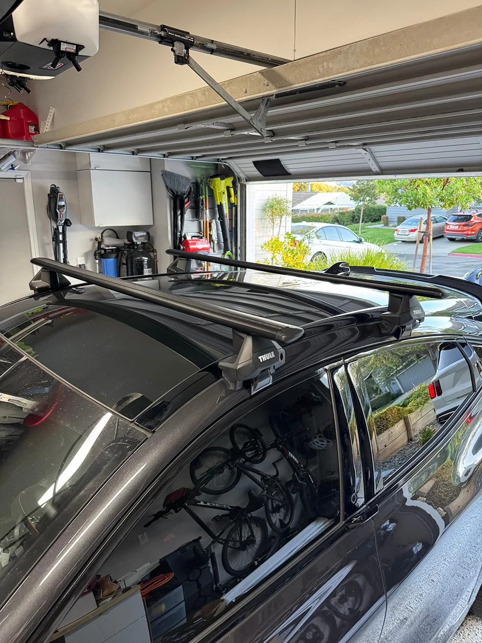

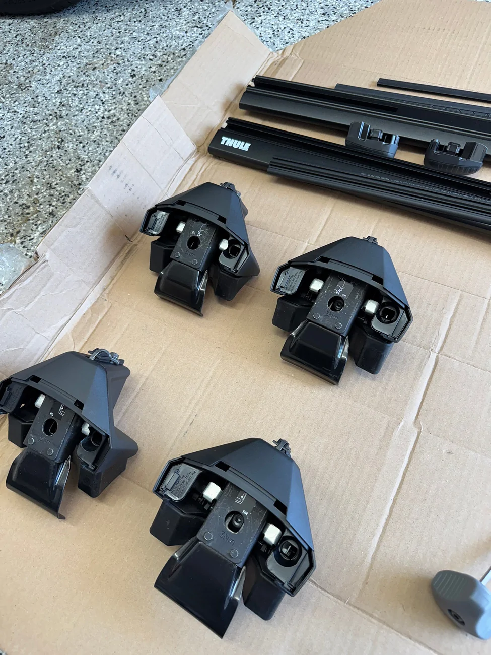

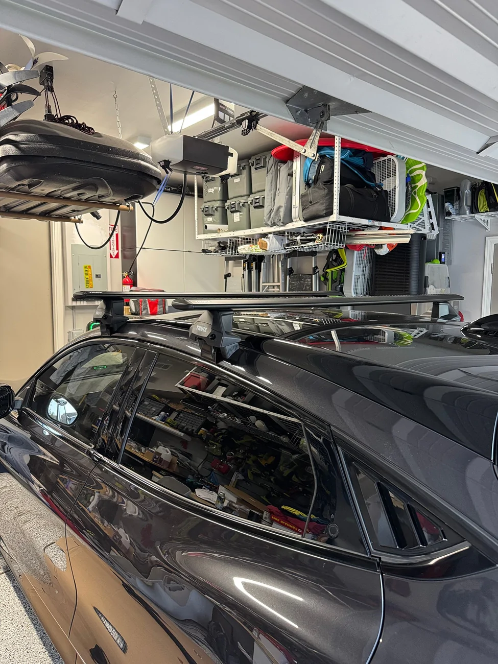

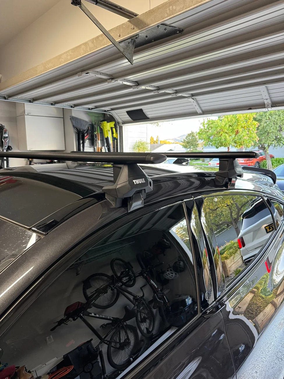

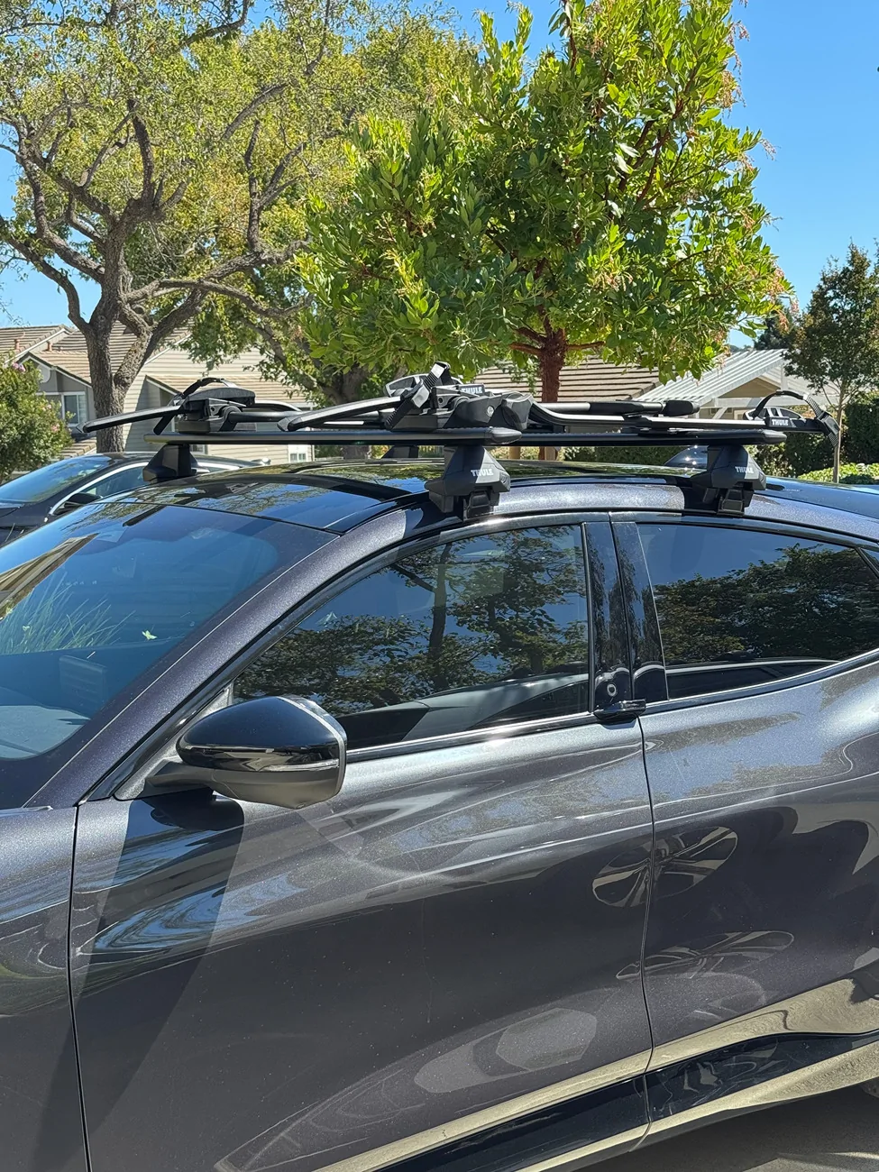

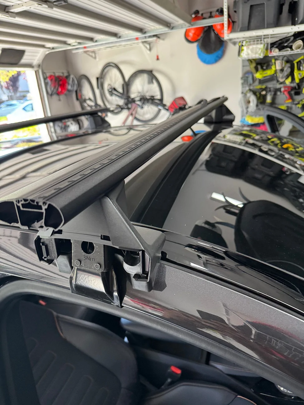

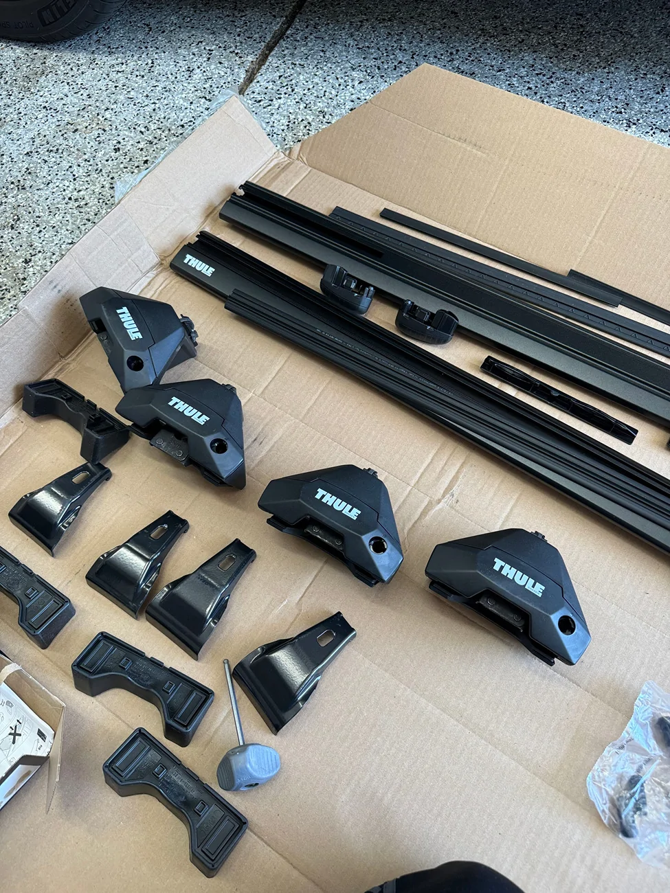

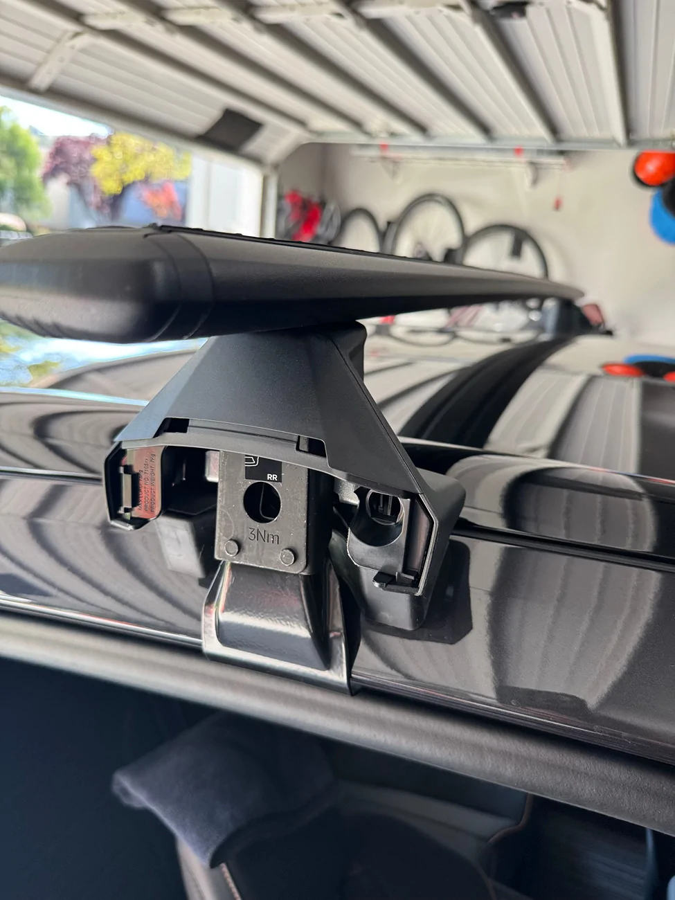

Bought Thule Roof Racks 60” as recommended and installed yesterday:
Mach-E Kit 145284: https://amzn.to/47Jo57U
Evo Clamp 710501: https://amzn.to/3K2NlMn
WingBar Evo 150 Black 711520: https://amzn.to/3K6HeGR
ProRide XT Roof Bike Rack: https://amzn.to/4gm6ftI
For proper installation, follow the provided instructions for clamp placement. If the clamps are in the wrong spots, the bars won't be level. The correct placement is 210mm from the windshield and 700mm from the front bar.
While the manufacturer recommends a clamp setting of 52.5, I found that 52 worked better for my car. A setting of 52.5 caused the bar to bend too noticeably.
Use the provided key to tighten the bolts. It's a torque key with a preset of 3Nm.

Thanks for the photos. I had ordered everything pictured, except I messed up and ordered the wrong type bars. New ones are being delivered today.
