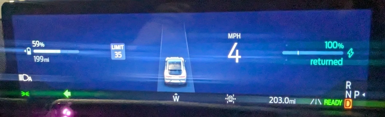

BTW you mentioned that it happens while accelerating. Since the friction brake is going to release the moment, you start accelerating, it certainly wouldn't "kick" at 5 MPH.
For reference, on how the Mach-E works, I find this demonstrates that. This is with my wife driving in 2 pedal mode. The "100% returned" is how the brake coach looks like on the 2025s. You will notice that at 4 MPH it is already announcing that all the possible regen has been reached.
