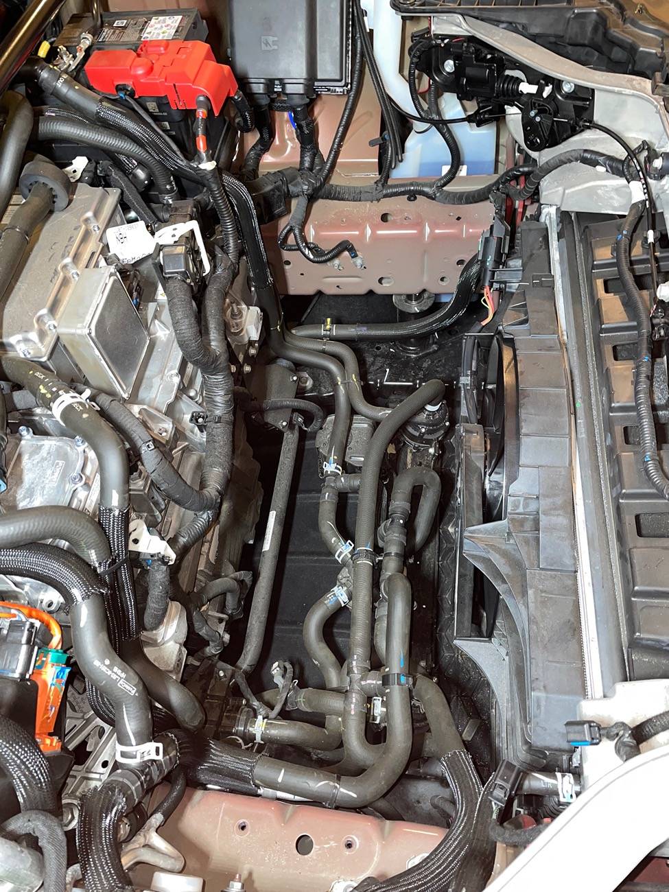

@Mach-Lee did you ever do any tests insulating the heater lines to see how that impacts cabin heat? I understand insulating the battery pack is a big benefit, but the reduced ground clearance by doing so concerns me. I'd like to start with just insulating hoses first and see if that is enough.
There was a guy on the Tesla forum back in 2019 that insulated the lines and battery pack and found a benefit. I think the link was previously posted. Otherwise O would need to do a repeat search
11,365
25,025
I did, but to be honest I did not see much of a difference at -15°F. The improvement in heat was less than 5°F. Most of the heat loss is though the surface of the battery (top and bottom).
