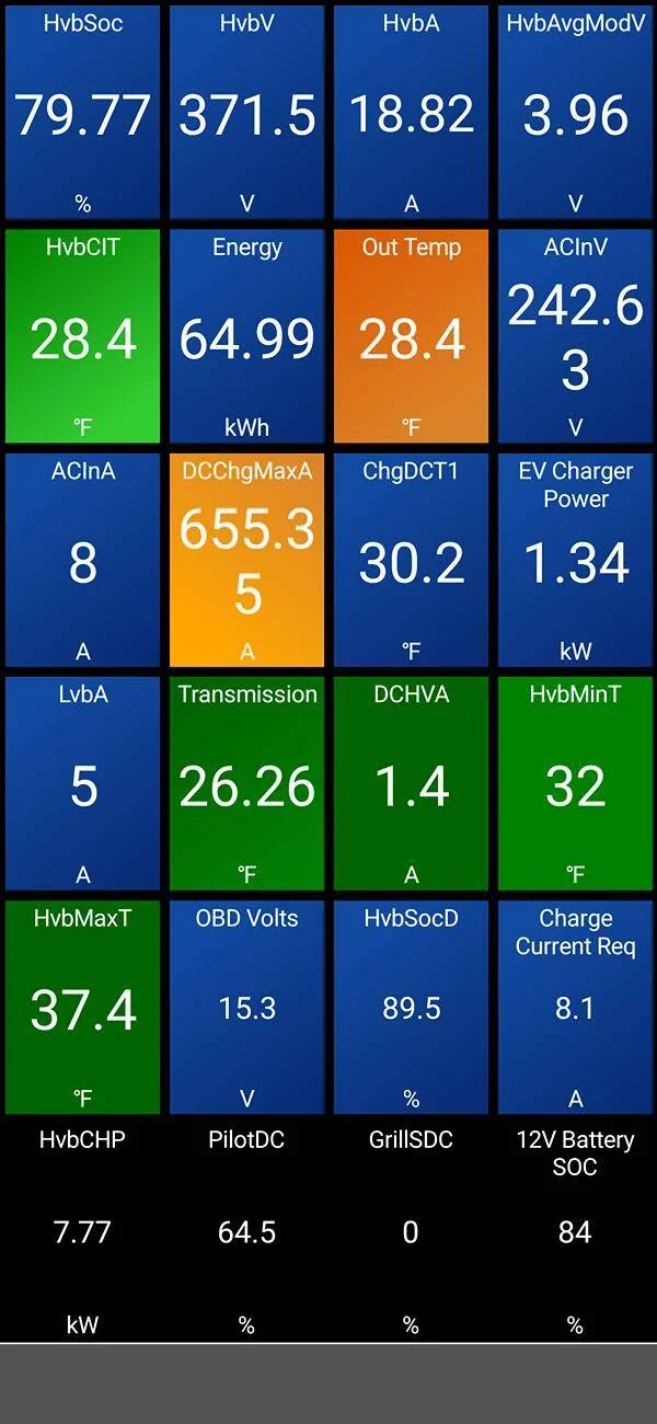

For better or worse, my garage has managed to hover just around freezing. But here are the car scanner results:
Ford Mustang Mach-E Turtle Mode (Cold Weather Warning) Screenshot_20250121-152448
This shows just regular charging. You can see my min temp is 32F and the max is 37.4F. No heating going on.
However, if I turn on the car (press brake pedal and push the start button), this happens:
Ford Mustang Mach-E Turtle Mode (Cold Weather Warning) Screenshot_20250121-152527
(I know it looks like the car is charging slowly, but it was in the middle of its stupid "stop-charging-and-then-ramp-back-up-when-you-turn-on-the-car" dance when I took the screenshot)
For some reason it's only then that it decides to heat the battery pack. Climate control in the cabin was OFF, and I could hear the pumps, etc. I've also noticed this behaviour a few weeks ago and did see that the coolant temp was increasing, indicative of battery heating.

Thank you for your account. I'm guessing what happened was the battery didn't heat on Level 1 charging, so it was very cold around ambient temp when you left. This means Turtle mode will happen sooner. The battery can be heated while driving, but often there is not enough heater power available to heat both the battery and cabin at the same time. If the battery is really cold, it won't even try to heat it while driving because you would lose all your cabin heat. I just finished a test at -25ºC, starting with a +12ºC battery it still cooled off to 0ºC despite the battery being switched in and heated while driving. That's the best it could do.
If you can only Level 1 change in very cold temps, it's probably wise not to go below 30% charge unless you've verified the battery temp has warmed up above 0ºC.
Agree. The car either doesn't have enough available power to heat the battery above 0ºC during charging, or there could be a software issue preventing battery heating in some cases.
I have a request, if you're in the cold north and have Car Scanner, can you check on battery temps while charging? Specifically, if the battery is below freezing to start with, does it get heated above freezing immediately during AC charging or not? It would be good to get data from both Level 1 and 2 charging, and different model years.
The battery definitely doesn't heat while on 120v and actively charging. I have historically noticed no battery temperature increase over the course of a cold day(not even passively from the charging process). So you are most likely correct as to why it happened at 40%. Not sure how cold the battery was actually, but it was probably close to ambient as it always is. With that said, in the same conditions last year I had this happen at 30% rather than 40%, so that's why I find it interesting. Even down to the 120v charging all day.
The battery doesn't seem to get any warmer while charging, and doesn't attempt to heat. but if I were to hit stop on charging, then it will start to warm the battery using 120v shore power.
Interestingly, my Bolt EUV would warm the battery even if it wasn't plugged in. It would intermittently warm itself while plugged into 120v. So my total charge for the day was power in minus losses minus whatever it used to warm the battery that day. I would average a net positive of about 8-10% charge. the mach-e will do 25% charge from an 8.5 hour charge period, even in minus 30c. Which doesn't really make sense, because even if I were to say I was getting 1kw to the battery from the charger, for 8.5 hours, that's only something like 10-11% total charge on a standard range battery. So something is way off in Fords BMS for sure. Maybe the BMS is way out of calibration?
Battery definitely heats at level 2 charging. the first thing it does it start the coolant pump and heater when plugged in and cold. It follows the same logic that they seem to have since 2021, 120v is charge then heat, and 240v is heat then charge.
