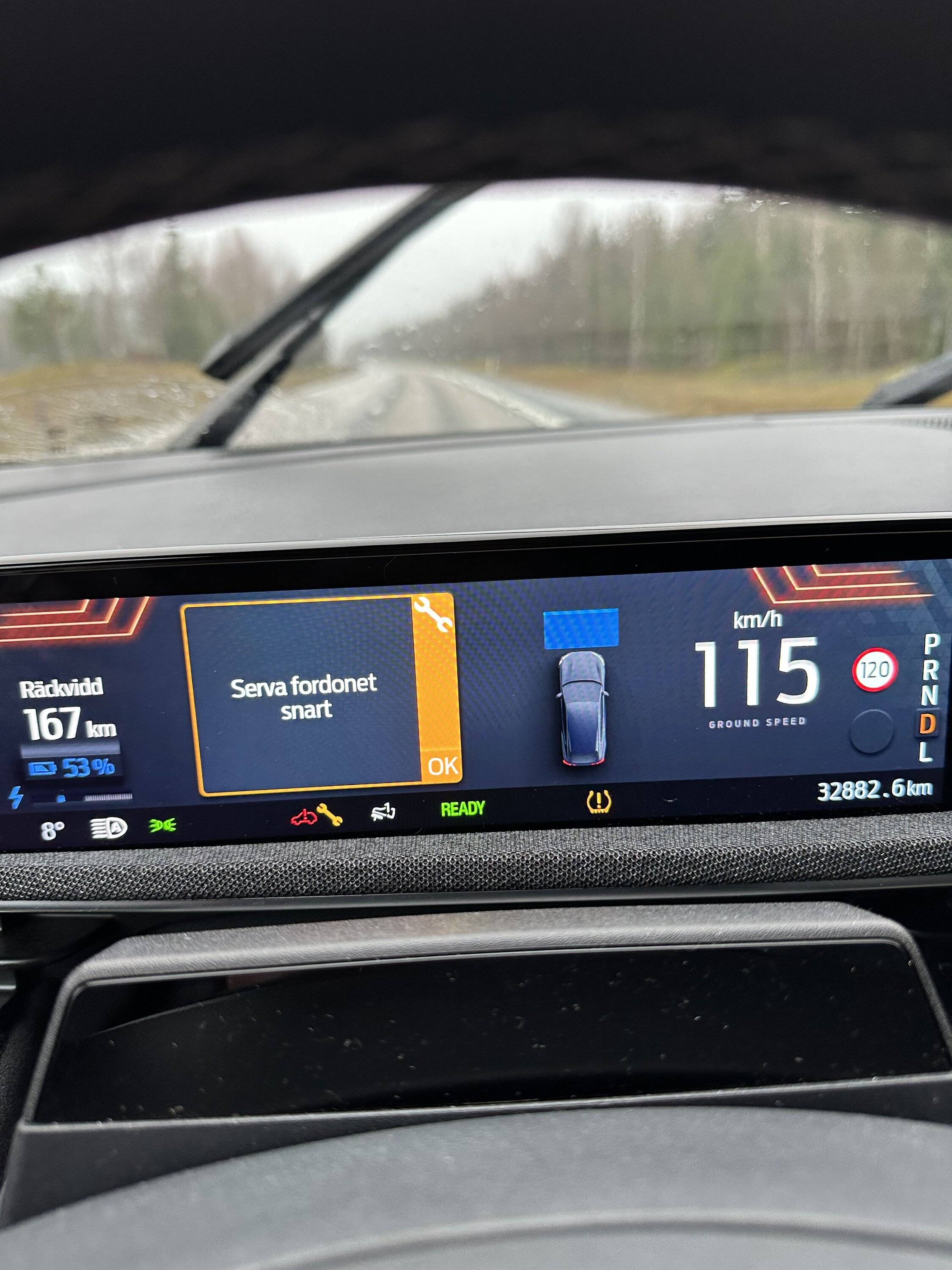

Hi!
Today I bought a 2022 Mustang Mach E GT with 33000km. On my way home I got a message about service and red light turned on. The maximum power was limited top 50-60%. What is this?
Ford Mustang Mach-E Turtle mode and service notice IMG_5054

I have no idea who you bought from (private sale or dealer), but it's very likely that you bought a car with a known issue - the failure of the high voltage battery junction box. The seller could have reset the codes, and then they tripped again.
A Ford dealer will look at your car in their FDRS system and see if it's the failed part, which will need to be replaced. In the meantime, you will have reduced power and your high speed charging will be limited to 47kW, more likely 41kW.

I went to the dealer today and they comfirmed its the HVBJB that need to be replaced and theres a recall.
But they told me they cant get the parts to fix it and doesnt know when the parts will be available..
