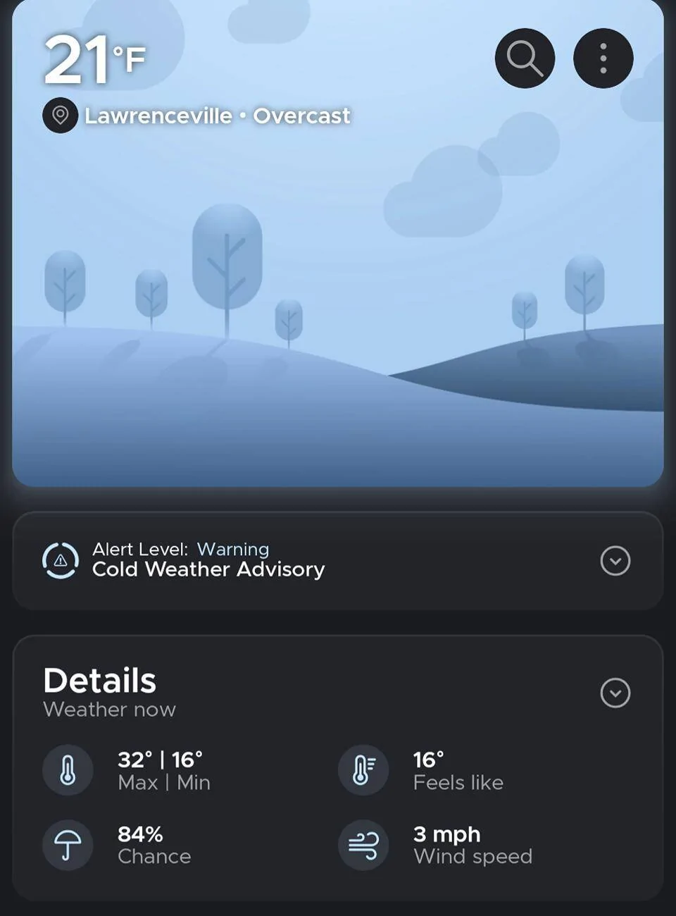

Clarification: This applies to cold climates with temperature below 20°F/-6°C. You don’t need to worry about this in the southern states or if you’re not discharging the battery below 30%.
Also the southern state of Georgia ???
Ford Mustang Mach-E Turtle Mode (Cold Weather Warning) 1000003579
Warming up to -20F here today. Good day for snowshoeing it is sunny, white and everything is sparkling. The car can sit today out but departure is set for tomorrow and it will be just as cold. 4 complete winters come Feb 3 and I have to say the car has worked fine in the cold.
