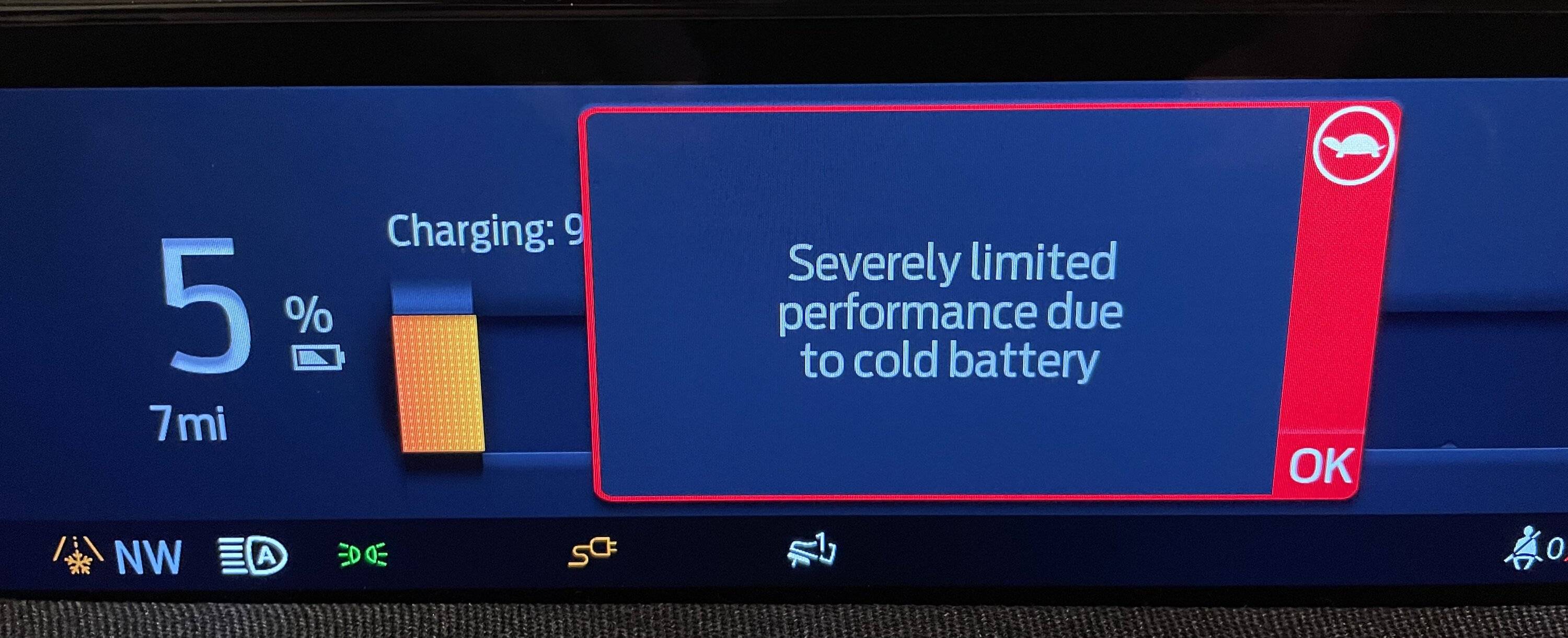

Warning: If your battery is cold, your car may unexpectedly enter turtle mode (power limit) with as much as 30% battery left.
You will suddenly have a severe power limit and will not be able to maintain freeway speed, nor accelerate through intersections or on-ramps safely. This has happened to myself and several others in the cold during the past few days. It's a really severe power limit and is pretty scary when it happens.

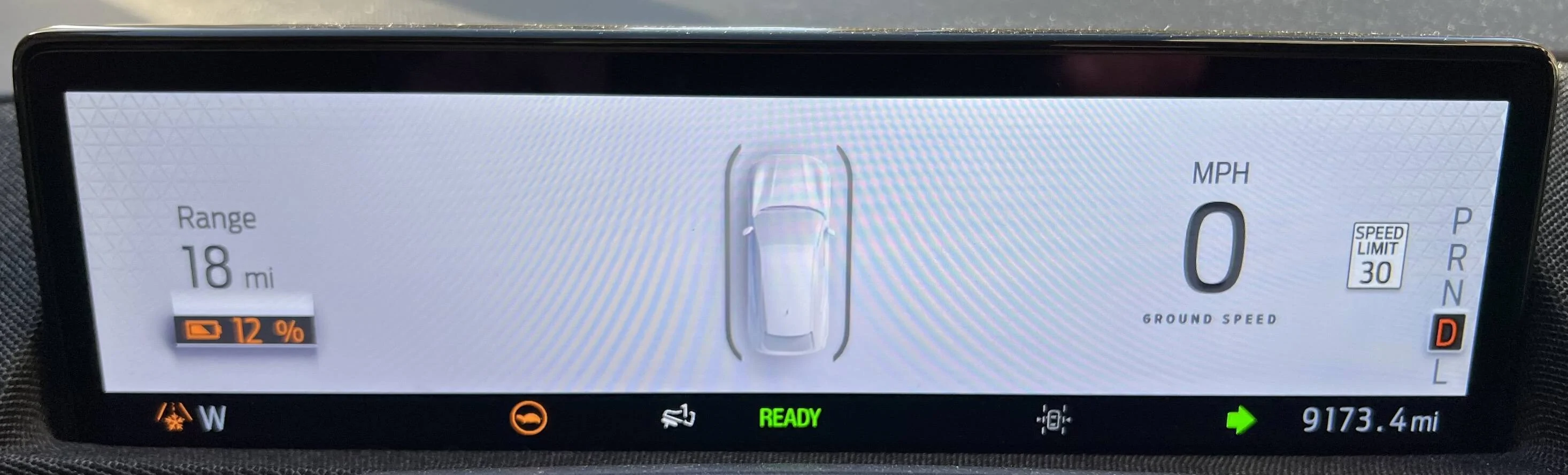

Yellow Turtle:

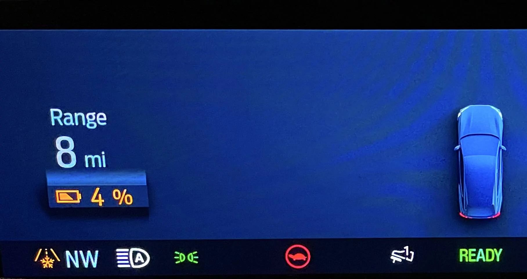

Red Turtle:
The colder the battery, the sooner you will get turtle mode. The power limit will get progressively worse as you keep driving until you are no longer able to maintain speed. It will start with yellow turtle warning "Performance limited due to cold battery" then progress shortly after to the above red turtle mode "Severely limited performance due to cold battery". At this point you have almost no power.
To avoid this, you must precondition/set a departure time, and plan your charging stops for no less than 20% battery in the cold. The GOM will still say you have many miles to go, but your car will be at a crawl long before it gets to 0%. I preconditioned and got turtle mode at 9% because my battery had cooled off enough while driving. Cold battery + low % SoC charge triggers turtle mode.
If you get yellow turtle, you need to take action immediately and find the nearest Level 2 charger regardless of what the GOM says. Slow down 20 MPH and/or get off the freeway ASAP before you have no power left. Your car will only have about 50 horsepower to accelerate, wait for all traffic to pass at stop signs and do not pull out on anyone.
