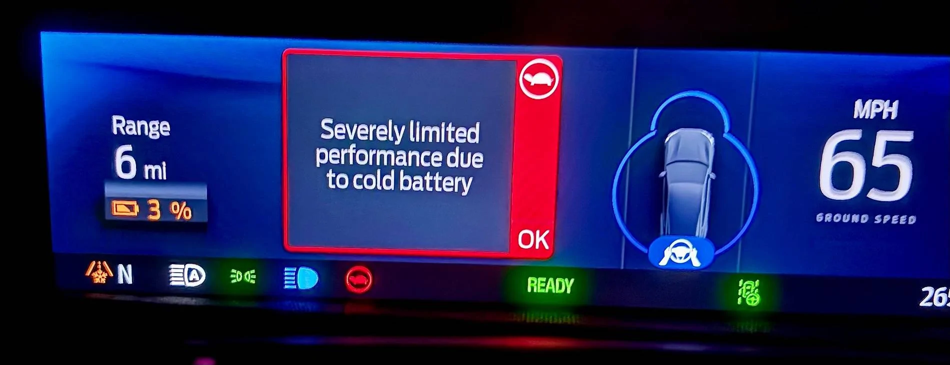

November 2024 Update - Turtle mode still exists in the software at low states of charge and low battery temps. Don't plan on going below 10% this winter. I had it pop up last night during testing:
Ford Mustang Mach-E Turtle Mode (Cold Weather Warning) IMG_0314
Outdoor temp 15ÂşF/-9ÂşC. Battery temp was 39ÂşF/+4ÂşC. The first yellow turtle showed up with 7% battery left. A couple miles later the red turtle shows up with about 5% left. After a while, red turtle switched back to yellow turtle. The algorithm must be dynamic based on voltage sag and recovery, you will probably notice red shortly after an acceleration, and regen might bring back yellow status.
I went home very shortly after the red turtle popped up (2% arrival), and the worst power limit I saw was about 55 kW or about 75 HP. You will have difficulty accelerating and maintaining speed up hills with red turtle mode active. The windows will also fog up soon after as the heat is cut off.
From my perspective, the cold temperatures I encountered were relatively minor, so I'm still surprised the power limit strategy remains very aggressive. The battery was relatively warm at +4ÂşC, so I don't think I should be seeing cold battery warnings. The car was heating the battery for most of the drive, it actually increased temperature from -1ÂşC to 4ÂşC and was using full heater power until about 3% left. The strategy seems to not want to let the battery voltage sag below 310V, which is about 3.3V per cell. This is a pretty conservative cutoff point for lithium battery discharge, it could be lower.
And I've said this before, but I don't believe the user should be subjected to red turtle mode before 0% state of charge has been reached. The bottom buffer should be dynamically adjusted so that doesn't happen.
Keep in mind the colder the battery temp, the sooner turtle mode will start. Which is why it's very important to try to warm up the battery before leaving on a trip where you may end below 30% SoC. I don't advise trying to go below 10%. And my advice from the first post remains, if you encounter yellow turtle slow down, get off the freeway, and find the nearest Level 2/3 charger ASAP.
Thanks for the update @Mach-Lee
I agree, 4C is warm. I've seen my battery at -13c and operating with no warnings at higher SOC (40%-80%). usually in the winter the system seems to try to get the battery to just above 0c somewhere while driving, so it's usually sitting at 5c at best by the end of a drive unless preconditioned first. I've been clipped for power and speed (amber warning) at 28%SOC with the battery at 5C, which is silly......that's a warm enough battery......
Ford needs to revert this programming so that our vehicles have access to the full battery in cold weather again. Honestly that's when we need it the most....
