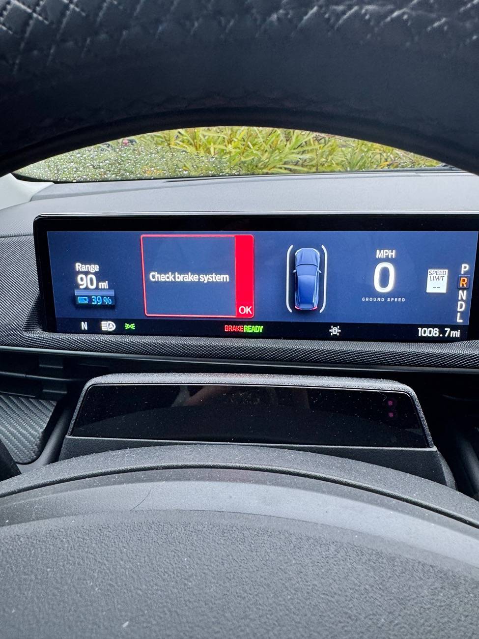

New car with only ~1000 miles. First drove off the road in December made in June.
Got check brake system error that won’t go away.
While I was in I also pointed out two other issues: wind sound at 60miles and high pitch sound form engine at 30miles.
I am told I likely have a brake fluid sensor issue (they will try to do a brake fluid flush and reset first though before changing sensor), they will be replacing front drive motor for the high pitch sound, and add foam to side mirror base (why that causes wind sound is a bit of a mystery to me but okay).
I can’t say I am very impressed so far with the build quality. ?

I am back to give an update.
Took the dealership about 2.5 weeks to fix everything.
For brake issue they flushed the brake fluids and then a software update (note my auto update so not sure what update this is).
For wind sound at 60m - they added foam near the mirrors apparently this is a known issue for some 2024. This made the ride much quieter though I still hear some wind sound it’s much less now.
For the high pitch whine at 30m. They changed the front drive motor. It didn’t completely go away but it’s way quieter now than it was originally (tone is a lot less grating than before).
Over all, happy with the fixes.
