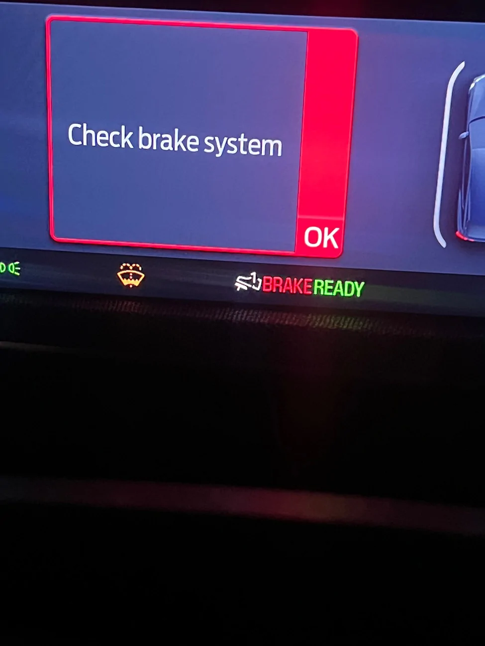

I have a 2022 Mustang Mach E premium with 100,000 miles, I recently replaced the four rotors and the four brake pads ( after market slotted/drilled rotors and ceramic pads) and after driving the car for about 50 miles the brake system alert is showing on my dashboard. I reset it and It came back, I took it to the shop and they test it with the computer and it is back again. Any ideas?

I would suggest you check your brakes
11,451
25,284
That is probably why. Suggest using OEM brake parts only, aftermarket brake parts have been known to cause issues.
