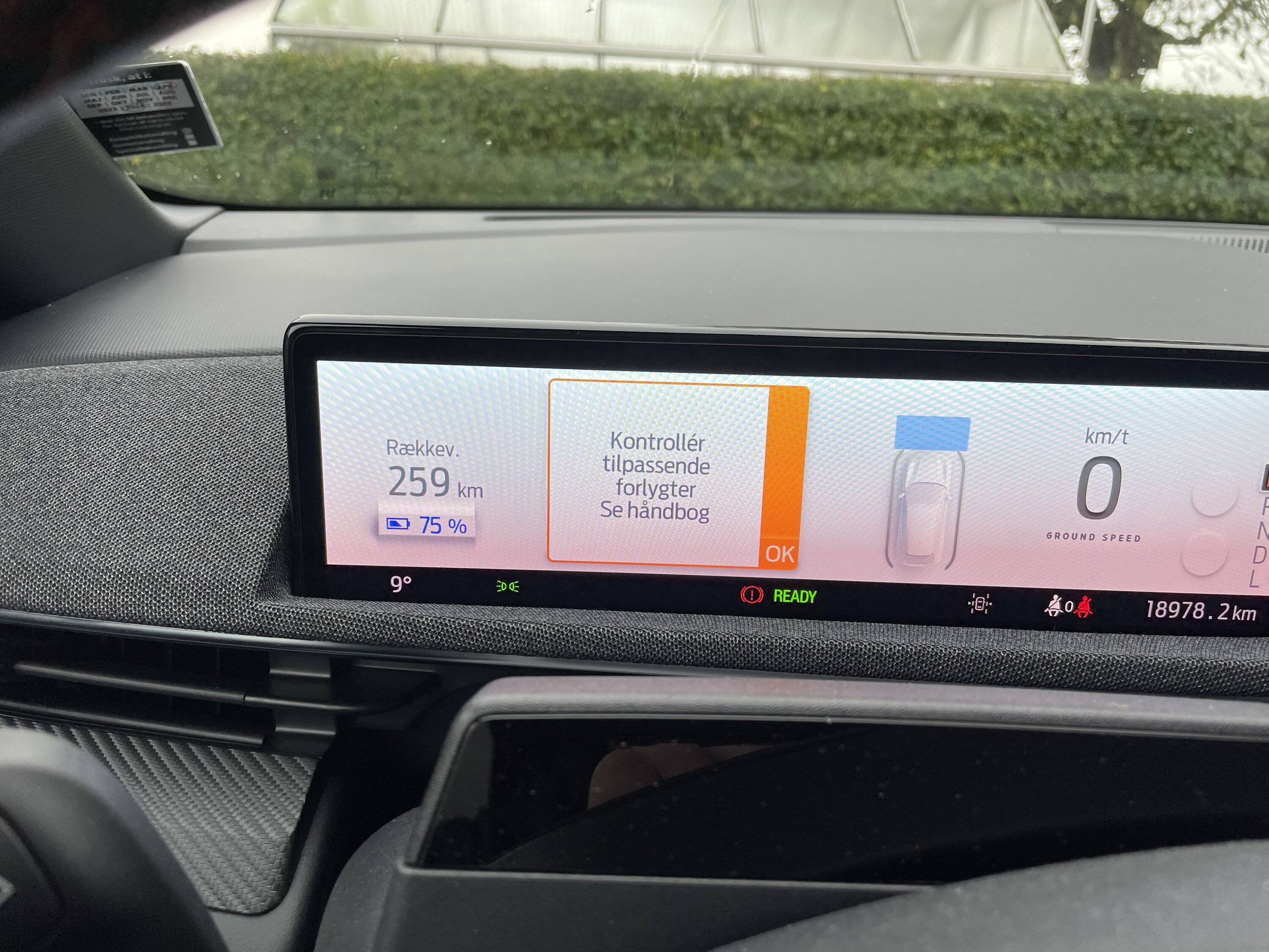

Hi guys
Just got this message on the small screen when I turned on the car a few hours ago. And I have turned on the car tried several times afterwards but still the same. And it has the result that none of the buttons on the steering wheel are working anymore and that is the same for any functions on the 2 'arms' on each side of the steering wheel. I can however drive the car but with no turn signal and windshield wipers, etc. it's not that safe...
Has anyone seen this before and maybe a solution to it?
I'll take it to the dealer tomorrow to have them look into it. Could be a faulty module...
I have attached a photo of the message - it is in Danish, but translated it says - check adaptive front lighting system - see the manual. And there is nothing in the manual referring to this message.

Hi guys
Best regards
Ole
Got it fixed today - a faulty module in the steering wheel was replaced and everything is working again
