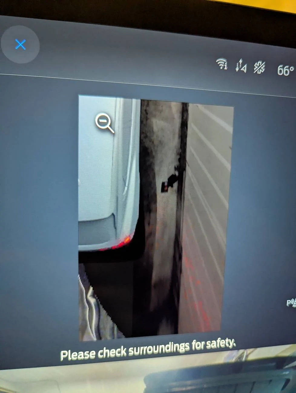

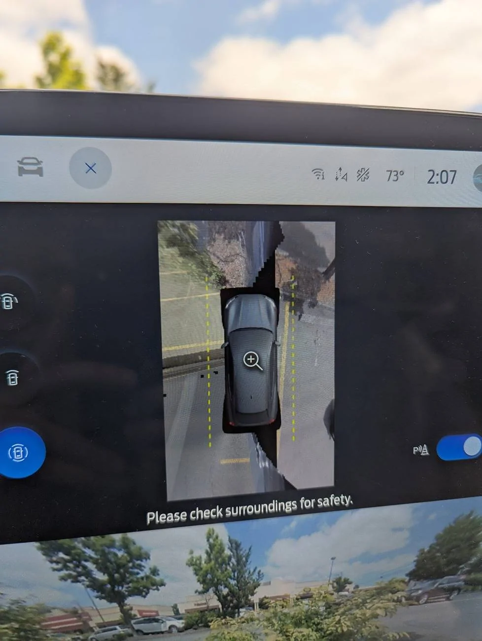

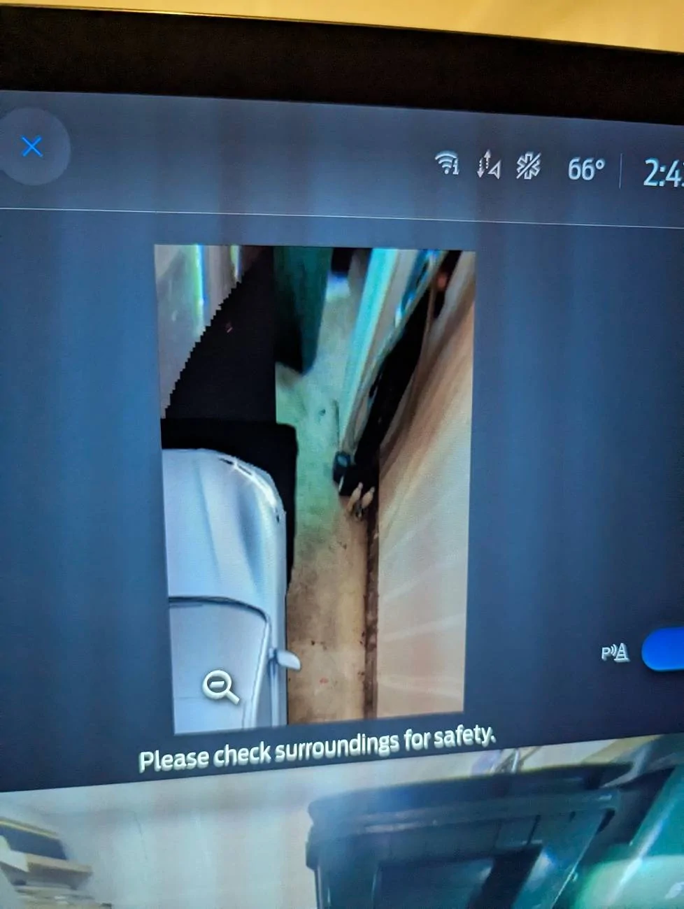

Has anyone ever seen an issue like this? Started driving today and out of no where I have dead pixels and a not matched stitching of the 360 camera.
Have tried soft and hard resetting Sync to no luck.
Any suggestions before I call the dealership would be helpful.

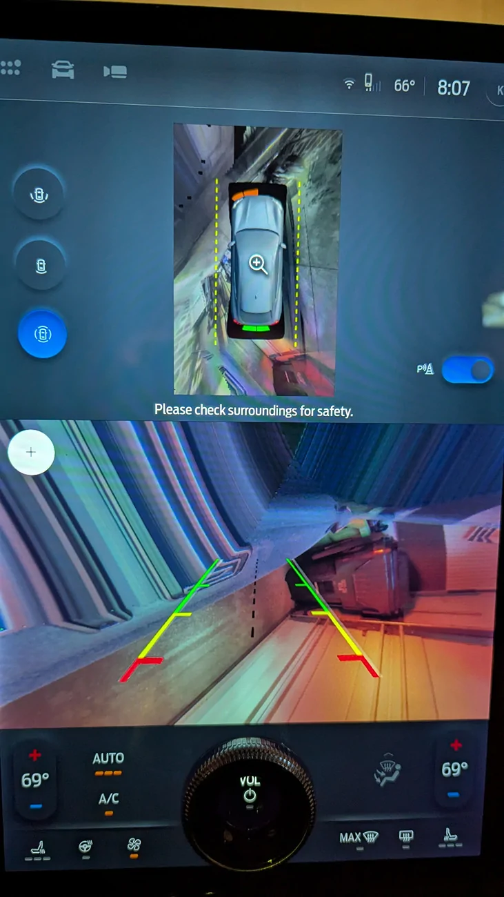

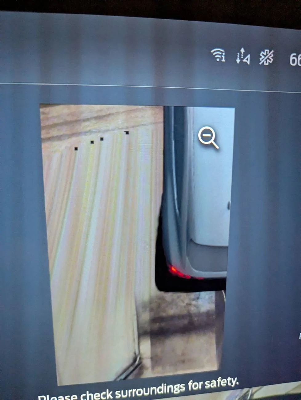

Mine has been looking like Technicolor Dreamcoat for a few days. Having a hard time figuring out what is going on. I tried a sync reset to no avail. May try pulling the 12V for a period. Have an appointment coming up, but I'd be happy to get it working beforehand as my dealership has been really slow lately.

If you have Forscan you can try resetting any codes. If you have FDRS you can force the CMR module to reboot. Otherwise 12volt pull might do the trick. I got lucky.
