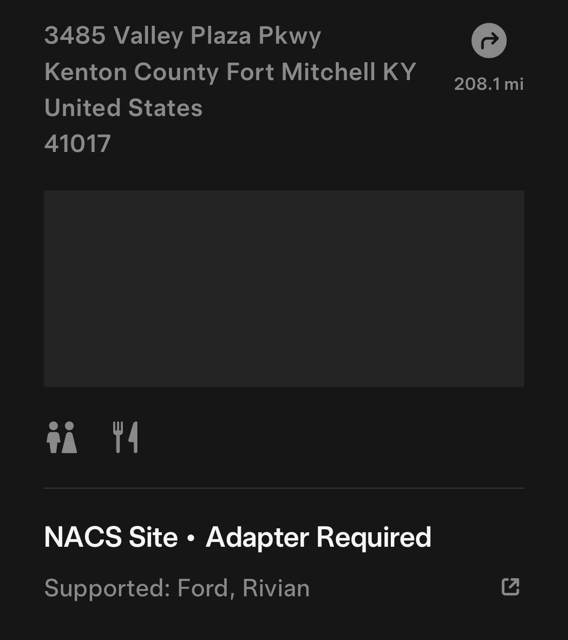

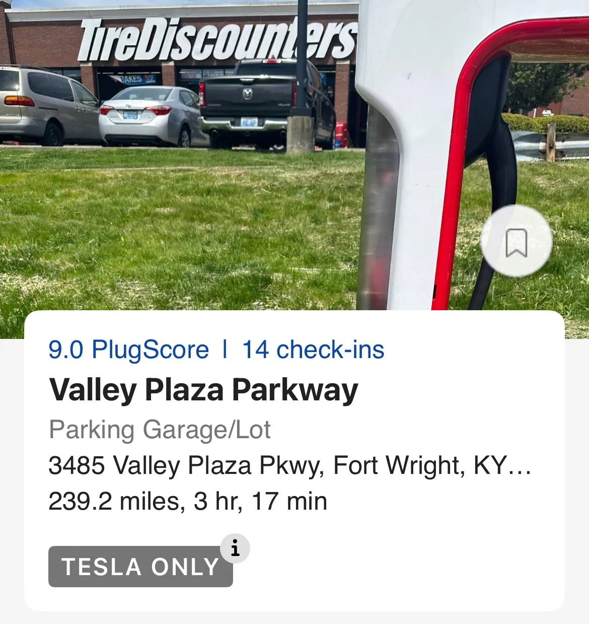

I made a mistake and told my wife that fueling this car would be cheaper than our previous ice that got almost 40 mpg. The price of gas was then almost $4 and it is now about $3.30, so now fueling our mme at many DCFC stations cost more than it would cost to fuel our previous car. For that reason we keep an eye on the rising DCFC prices. I have fortunately been able to find stations that work fine at much lower prices than Tesla or ea. I just do a little more homework. I suspect that prices will climb rapidly if people have no concerns about how much they pay and select the highest priced electricity when other lower priced DCFC in the area works just fine. Maybe some people wouldn't mind paying $1.50/kw but my wife would remind me that it makes more economic sense to stay near home until we went back to ice.
Jeff, I couldn't find any Tesla prices on plugshare where I recently traveled to and I didn't understand from your answer if they are listed where you traveled to or did you look at the Tesla app?
