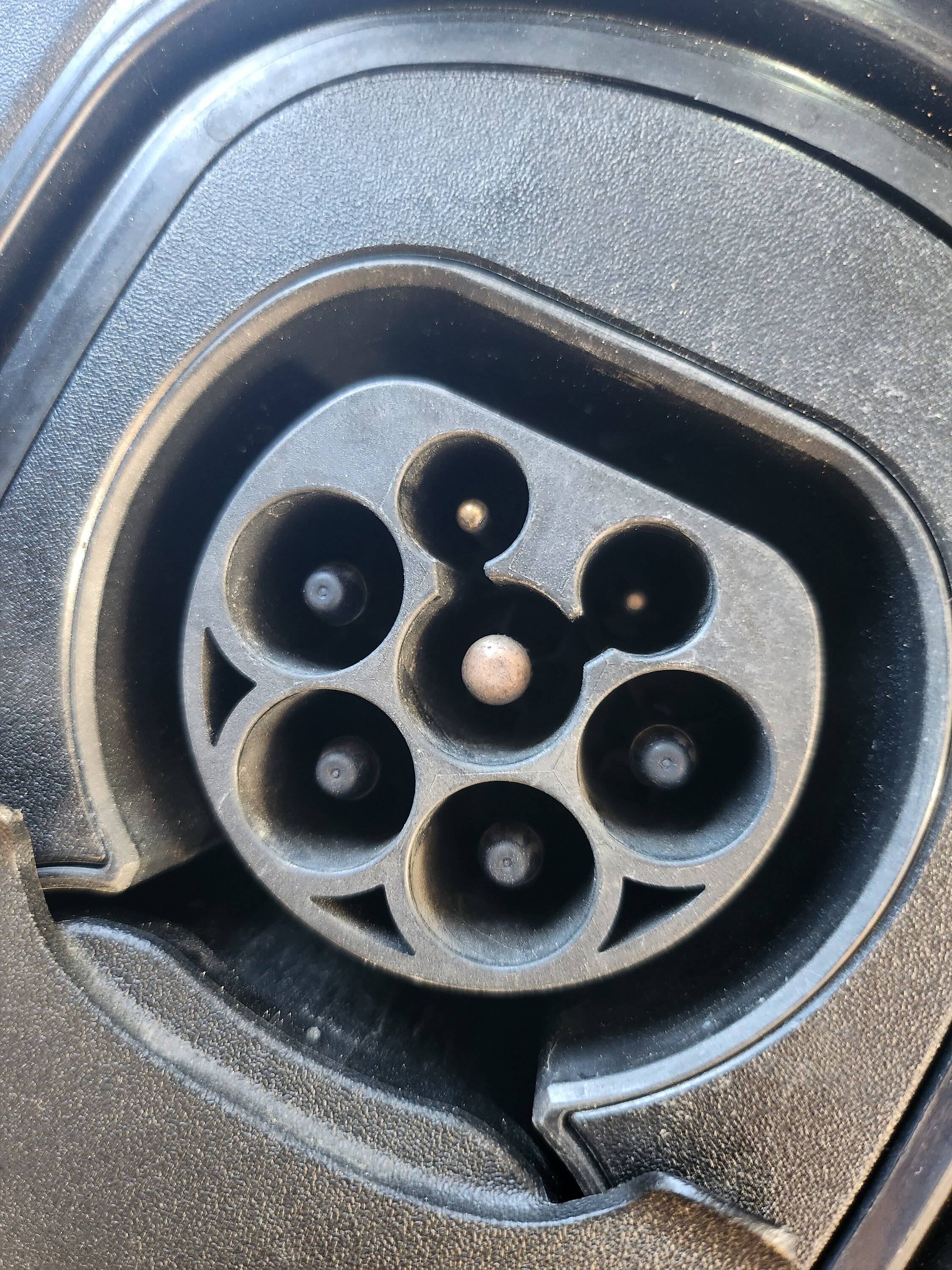

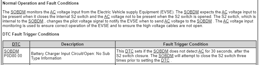

AC won't charge "SOBDM P0D80"

I have an appointment next Monday at the dealership, I hope to get out of doubts, and I say “hope” because every time I visit the dealership I get some "surprises" and they take a long time to make accurate diagnoses.
hi, can you Tell me what the Problem was? Please.
I have the Same issue, so please let me know if you could solve the Problem, and what did the dealer say..?

The AC Charger was broken und the Dealer changed it under warranty
