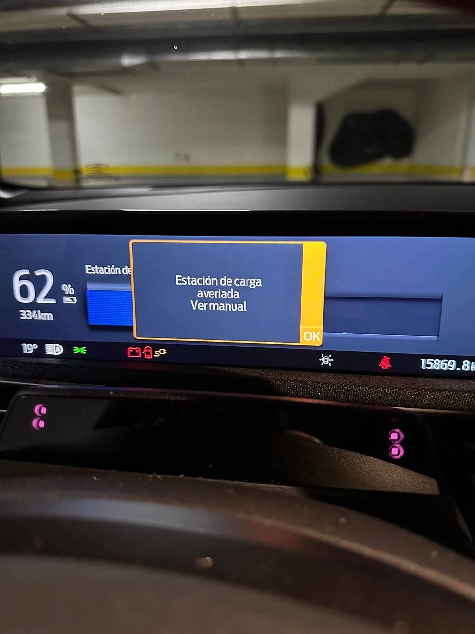

Just today I got this error and the same problem.
I can't charge in AC, and I can charge in DC.
I have tried two different AC chargers and both give me the same error.
Ford Mustang Mach-E AC won't charge "SOBDM P0D80" IMG_7910
I have not seen that one yet. Does that "station" off to the left of the message cutting the border appear on the IPC? Blocked out station and broken with same smaller font? Looks glitchy. Ford is now coloring out of the box ;)
Think I would check a few chargers. Message says it is the charger? It would be good if you know someone with an EV have theirs charge and yours not. There are not that many EV's up here yet but we have a few public L2 chargers. Maybe find one that someone is using and try that one after?
Thank you!
I have already used 3 different L2 chargers, checking that they were working before, on all 3 the error is the same. Seems to rule out it being the charger. Seems more some of these problems:

Did not answer my question is that "station" in your pic displayed on the IPC?
You have DCFC just not L2. Bummer workaround. Two different systems and connections so it is possible one is working and one does not. Good to have workarounds, redundance. Hope for a speedy recovery.
Thanks!
You’re right; I didn’t answer your question—sorry about that!
The answer is NO; that “station” word is there because the screenshot is a picture translated by google from Spanish to English. Here’s the source:

Should of guessed based on country my bad. When in doubt say it is the charger ;)
