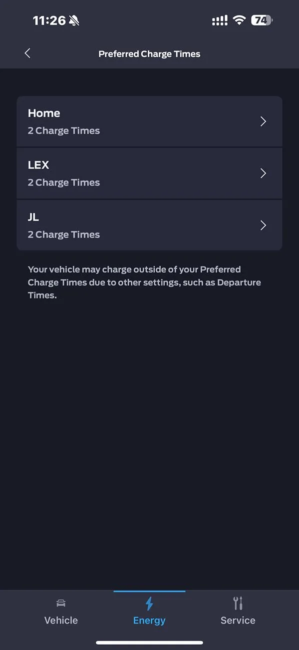

Is it me or it isn’t possible anymore to add a charging location in the FordPass app? I can add it in SYNC , but I don’t see such an option in FordPass.

Go to the 'Target Charge' tab instead of 'Preferred Charge Times' to add the location.

Thank you. Somehow I missed it. It’s strange that it’s a separate menu now.
