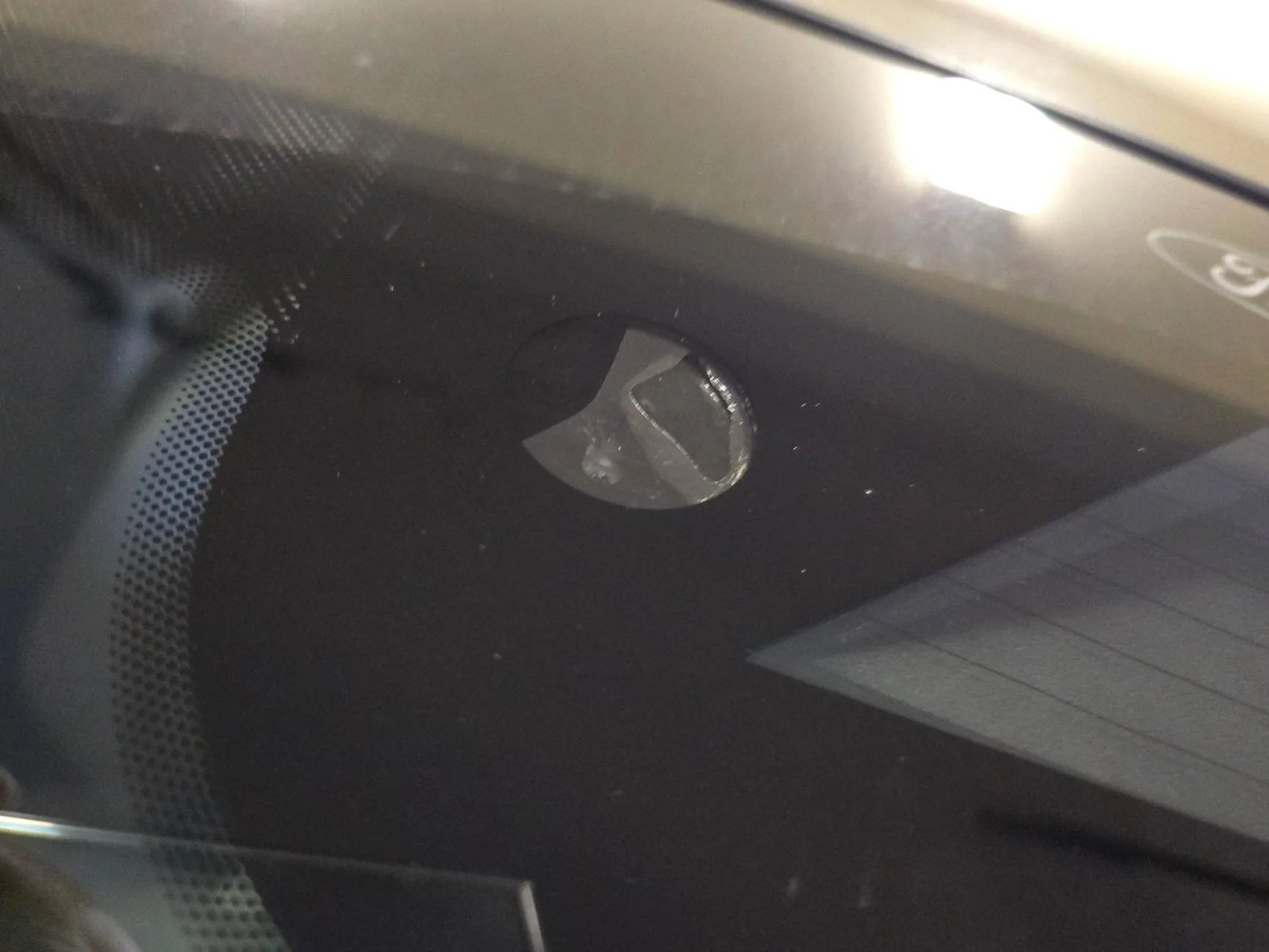

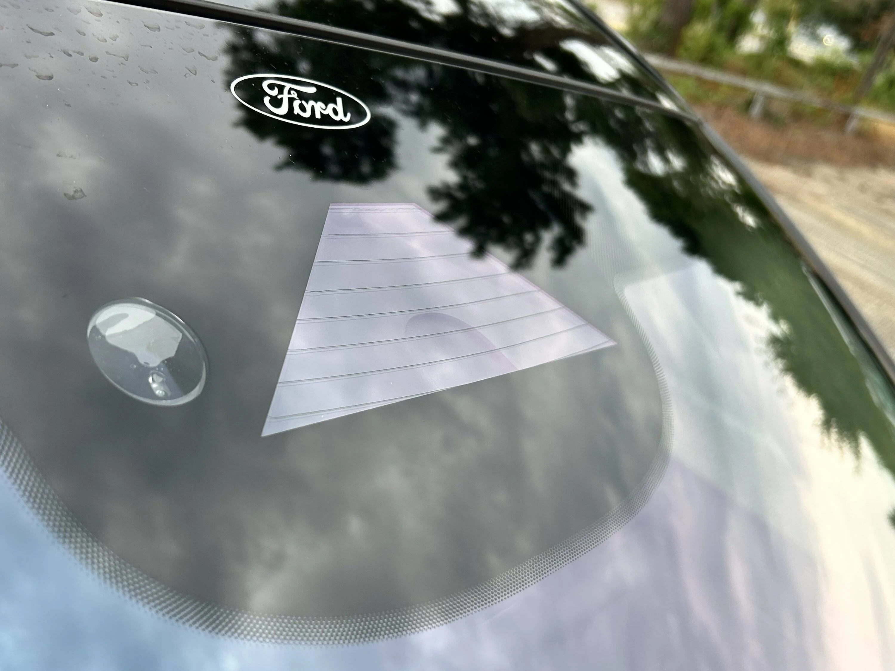

@Mach-Lee, so glad I found this thread after searching unsuccessfully before. My auto rain sensor is also not working anymore. I did have my windshield replaced due to a crack earlier this summer, but it didn't rain immediately so I didn't connect the two. This is what mine looks like. It doesn't seem to have air bubbles but looks odd. Is this the gel issue also?
Huge air bubble there, that's not going to work at all. It's only making contact at the 9 o'clock position.
