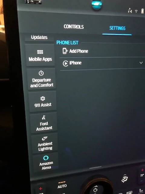

i dont have anymore... i did update by myself by FDRS... in one update i saw the icon of Alexa in main screen... after, other update (again by FDRS, immidiatly after the first) that icon desapeared... i cant see my version (if i open update tab, i can read System is update).
Do you have the new updated UI? If so, look to see if Alexa is an app on the main screen now. I can’t really help beyond very basics as I don’t use Alexa and don’t have it installed. On the old ui Alexa settings are the very last setting snd need to be scrolled down to see them.

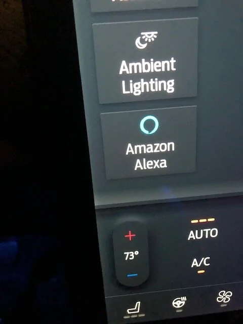

Make sure you scroll the settings menu. Alexa is hidden when you opened settings in the old ui.

I had Alexa by FDRS too, it was "awaiting for activation" in my Ford account but no icon on SYNC. The only solution was a SYNC master reset and the Alexa icon showed up in SYNC for activation.

Yes, I had to do a brand new setting but it worked for me. I needed to re-activate Ford Connect but FordPass app reset was not necessary, I had just to reconnect it.
