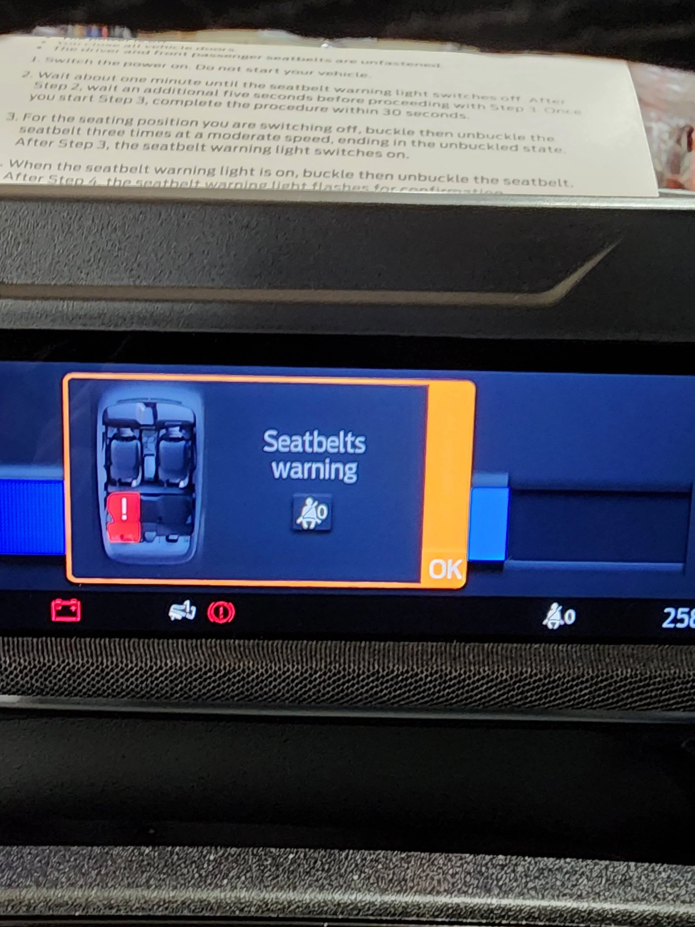

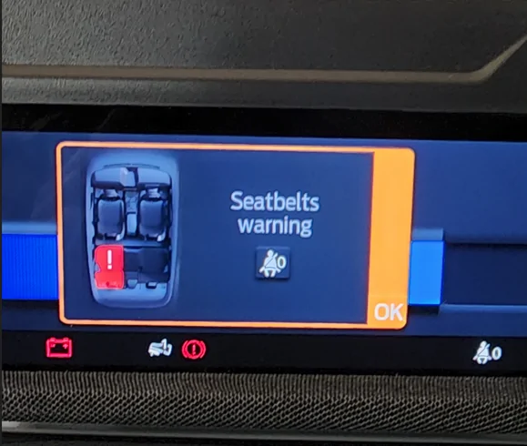

Unfortunately it only seems to work for the front seats and not the rear...
Ford Mustang Mach-E Are these options available to change (via FORScan)? 1679180785937
I'd like to disable this as it gets a little tedious pressing the OK button 50-100 times per week!
Ford Mustang Mach-E Are these options available to change (via FORScan)? 20230318_155048

This seems to ONLY be for the driver and front passenger seats, not the rear seats.
