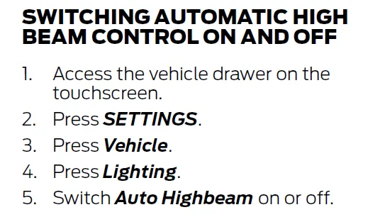

where on the touchscreen is auto high beam setting?/QUOTE]
From pg 109 of the U.S. manual, not sure how applicable it is to Euro cars or which trims have auto HB. Same page has directions for overriding high beam with lefthand steering wheel lever.

The system turns the high beams on if all of the following occur:
  • You switch the system on.
  • You set the lighting control to the autolamps position.
  • The ambient light level is low enough that you require high beams.
  • There is no traffic in front of your vehicle.
  • The vehicle speed is greater than approximately 32 mph (52 km/h).
