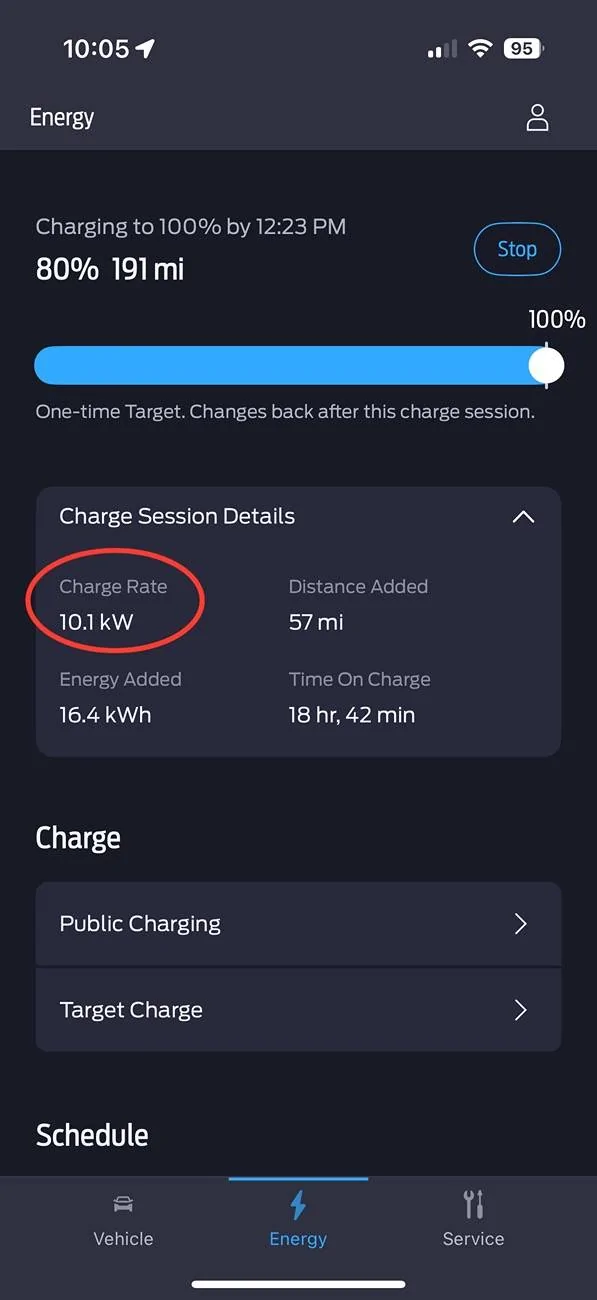

Thank you. Can that be done with L1 (120 volt) charging?
Yes, it just takes a lot longer to charge. The idea is to get the car to think its battery is nearly empty and then to bring it up to where it thinks it’s at 100%, then let it sit for at least 8 hours so that it can rebalance everything. ??

Echo the posters above. Could be a problem with your EVSE or wiring and it’s de-rating the charge speed from overheating or some other issue.
But also unless you are truly using down to 20% from 95% everyday, there is no need to wait until 20% before plugging in to charge. Set a lower limit and plug in every day to recharge, which is 1) healthier for the battery and 2) less stressful on your EVSE and wiring because you aren’t pushing out high voltage/amperage for such long periods at a time which means less heat build up.
