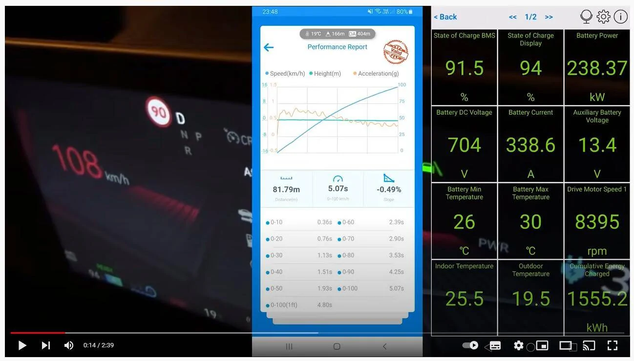

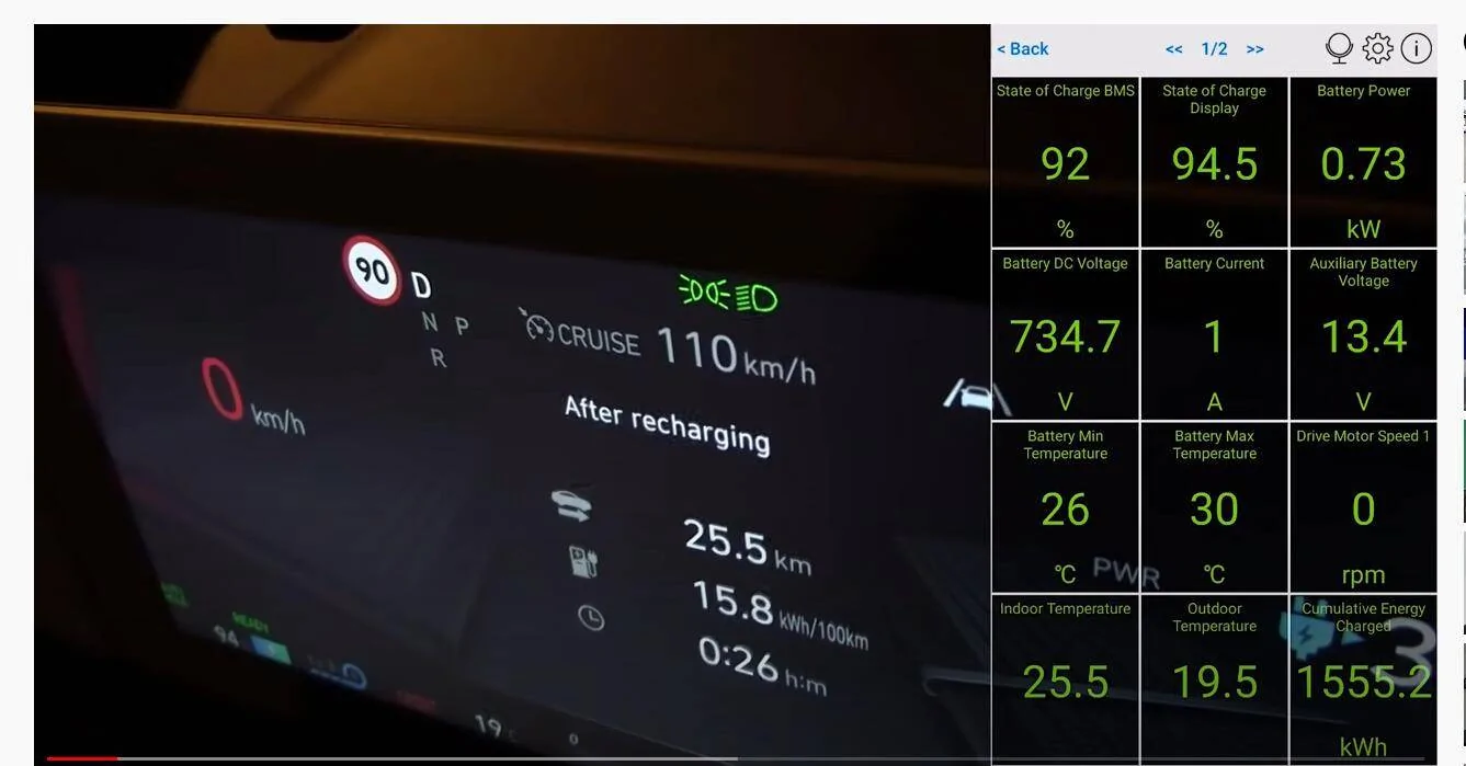

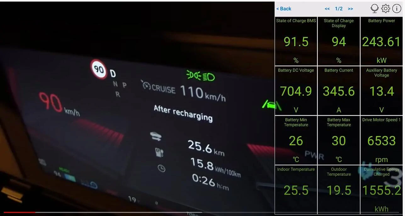

Warning: More battery nerd talk.
The big battery really spreads the heat out - it takes large batteries a long time to heat up. From the Ioniq numbers you gave (I didn't watch the whole video) a 5% voltage drop on a 380V battery (guessing the SOC) would be 19V of drop while drawing 657A, for an internal resistance of 28 mOhms. That would be a very good value, but plausible, with the MachE ER at 35 mOhms.
Minor correction. Ioniq 5 is a 800V system.
30V drop (734v to 704v) after pushing 345.6As to reach 90-100 km/h (around 60mph). See images I snagged from the YouTube video. Of this is an ideal state because of the SoC over 90% and the temps are in the ideal range for a lithium battery (26-30C)
From what I've seen from Bjorn's spreadsheets the Ioniq 5 is the fastest EV from 0 to 100 km/h beating the Model 3 and Mach-E. For a "family sedan" it's going to wipe the floor in terms of raw acceleration.
