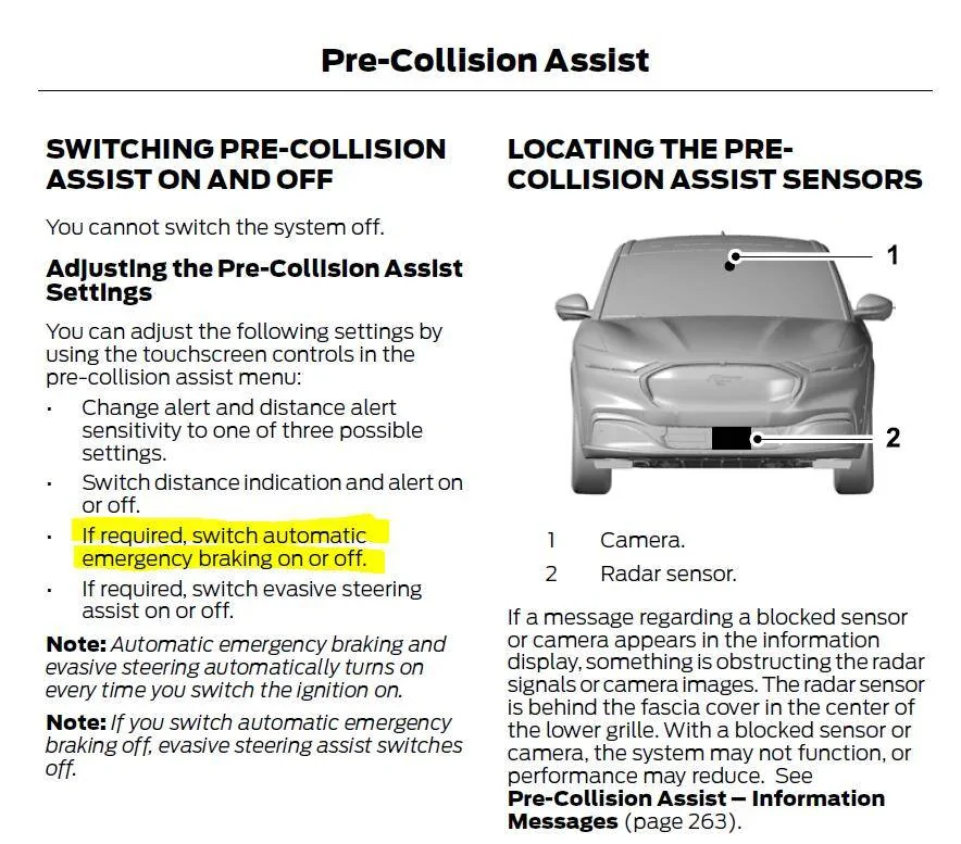

Have you had the ADAS camera and radar sensor calibration checked at a Ford Dealer? That would be my first thought, because this is not normal or widely reported.
Auto braking can be disabled.

That's a limitation of the system. You'll have to either turn it off, or be prepared to override the braking by immediately pressing the accelerator pedal. You should be able to learn where it usually triggers and just hold your foot over the accelerator pedal passing those areas.

He stated he can turn it off, but it turns back on next key cycle (as the manual states). Cannot be turned off permanently.
