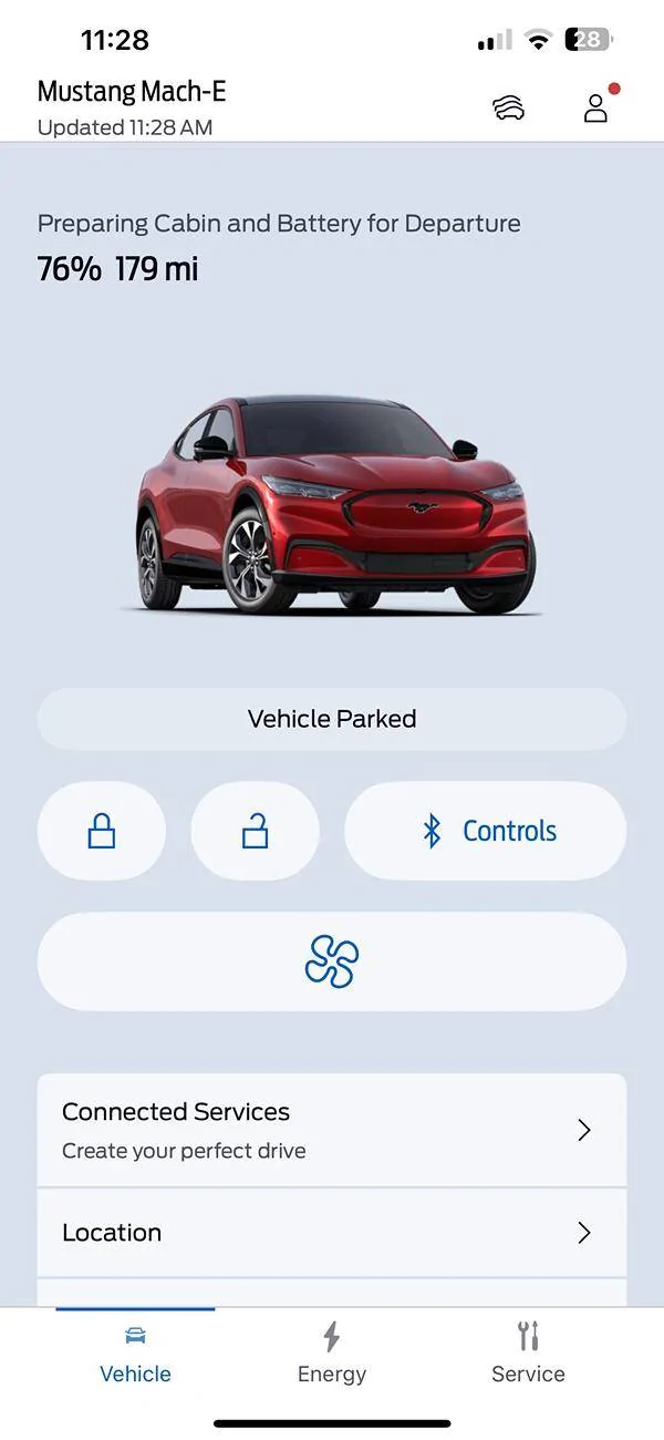

Yes. I haven’t had a chance to force reset everything. I deleted all departure times and recreated them. Same symptoms.
Here it is now.
Ford Mustang Mach-E Car is Always Preconditioning when Plugged In IMG_0774
