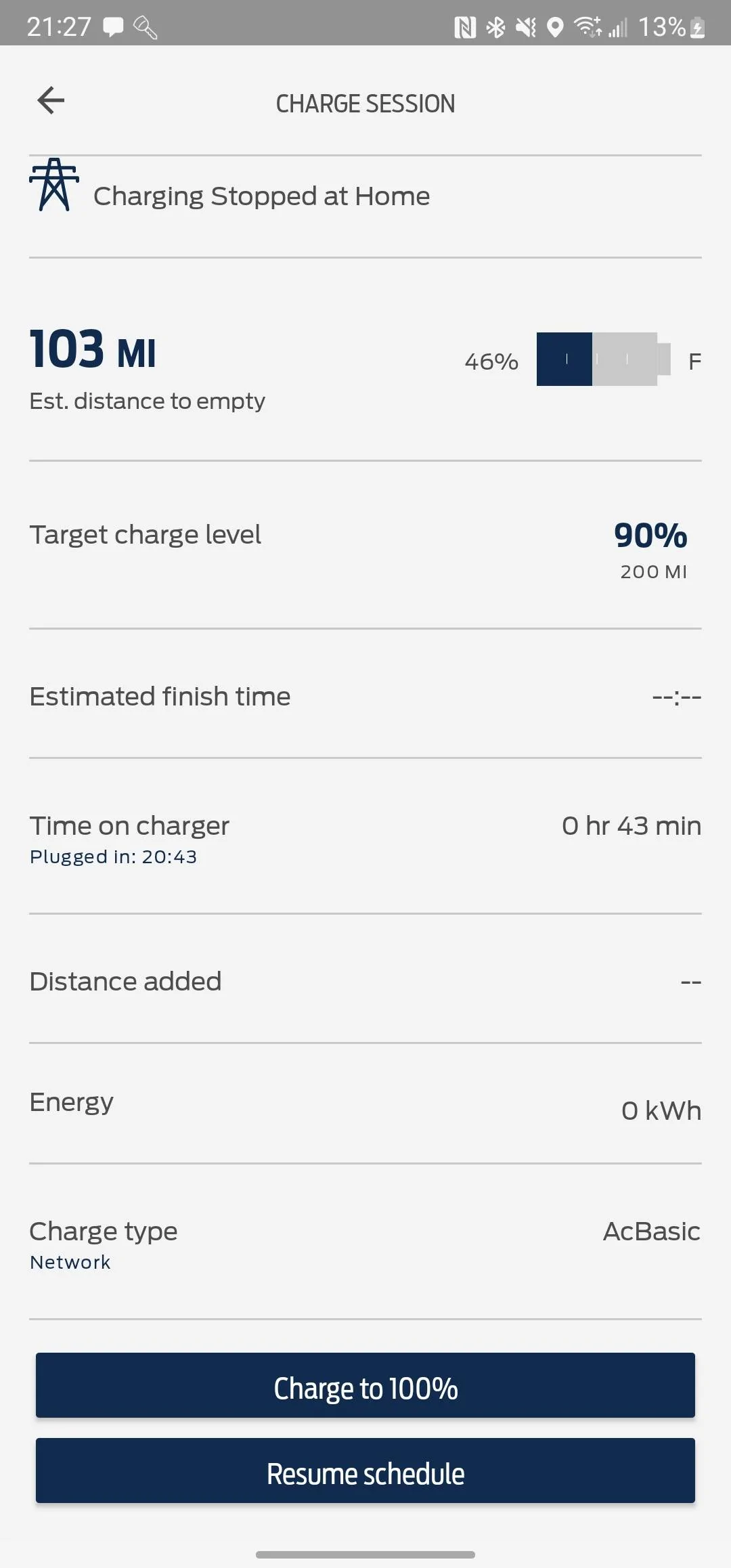

Yes, tried that. Does nothing.
Here is a picture of what it shows.
So what happens when you press “Resume Schedule”? Still nothing? Are you using the mobile charger? Heard people have issues with that. (amber lights, dongle not plugged in all the way).
When I press resume schedule it works, but have to do it everytime now to get car to charge. Using chargepoint and schedule turned off.
