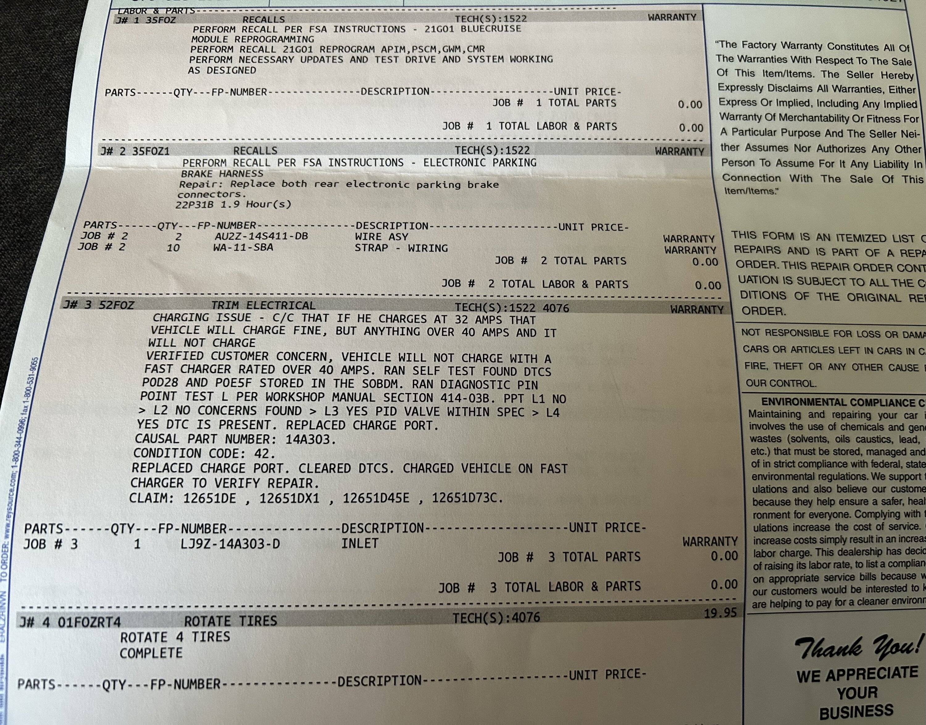

Yep, I had this same issue. It only impacts level 2 charging, using a level 3 charger won’t recreate the issue. The dealership recently replaced my charging port and it resolved the issue. Right before they replaced it, it had gotten so bad that even 30A would trigger it to stop charging on occasion…thankfully it’s no longer an issue.

I just got my car back from the dealership and it was in fact the charge port that needed replaced. The work was done under warranty. I have been happily charging at 40A for an hour now without issue. I HIGHLY recommend opening a ticket with the BEV team at Ford as the smoothed over the process quite a bit with the dealer.
Ford Mustang Mach-E Plugged in Not Charging C7F49B3E-7A31-401F-8B0E-EB8B69CF4BDE

The BEV team was incredibly helpful for me. They confirmed that my vin was on a list of cars the they know the charge port is an issue for. They worked closely with the dealer tech to handle it for me. They would be the ones to tell the dealer if this is a hardware issue or a software one.

Did your car have the yo-yo charging? Mine always charges so it may different than yours . It just goes from 40-32-40-32 constantly, never shuts down and no alerts whatsoever

Yes it did yo-yo charge. If 40A or higher it pretty consistently wouldn’t charge. 32A and higher it would yo-yo down to something like 24A. Replacing the charge port fixed that too.
