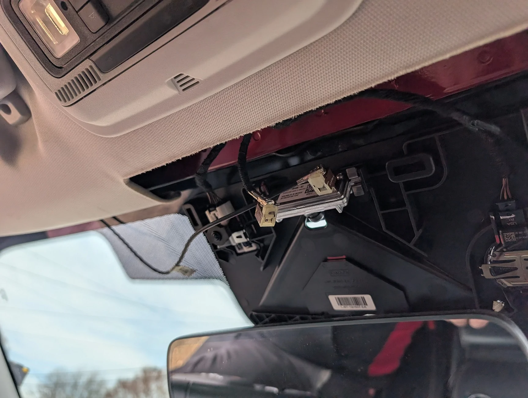

Hey I'm getting my windshield replaced by Safelite. The guy showed me this because he was confused as to why it was that way and saying it could cause problems with calibration. For some reason there are two cables running to the camera that's in the windshield. Anyone know why or if it will cause any issues? I got the car new from ford

I believe it is for the rain sensor for the automatic wipers, it is mounted next to the camera. FYI, the Mach E camera automatically calibrates after driving it a couple of miles.

Looks to me as if the camera coax cable (from the camera to the A-piller) was replaced at some point. This cable is a common problem related to "Front Camera Fault" errors. When replacing this cable, it's good practice to cut off the ends of the defective cable so as not to confuse the next person who opens up this area. Appears as if the person who replaced the original cable was lazy and didn't do that.
