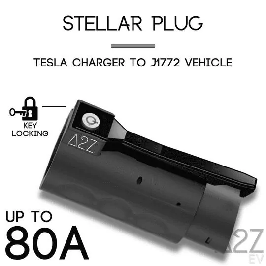

If you need an adapter for your Tesla home charger, A2Z’s Stellar adapter is very good and priced right - $108 ($102.60 with code FORDFORUM). https://a2zevshop.com/collections/charging-adapters/products/a2z-stellar-plug?ref=Typhoon

You can use your level 2 Tesla charger at home with your Ford Mach-E if you get a A2ZEV NACS to J-1772 adapter like the A2Z Stellar AC adapter.
This is the same adapter you will use for Tesla destination chargers commonly found in hotels / Parking lots / Shopping centers and Airbnb. This is a much better option than using level 1 charging.

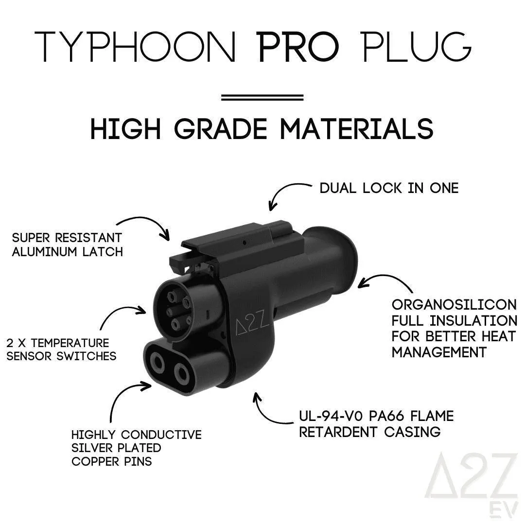

You will need the DC Level 3 Typhoon Pro adapter to charge your Rivian at eligible Tesla Superchargers.
You can bundle the A2Z Stellar AC Level 2 Tesla to J-1772 adapter for $99 additional after discount
You might have to update the setting for non-Tesla compatibility on your Tesla home charger.
