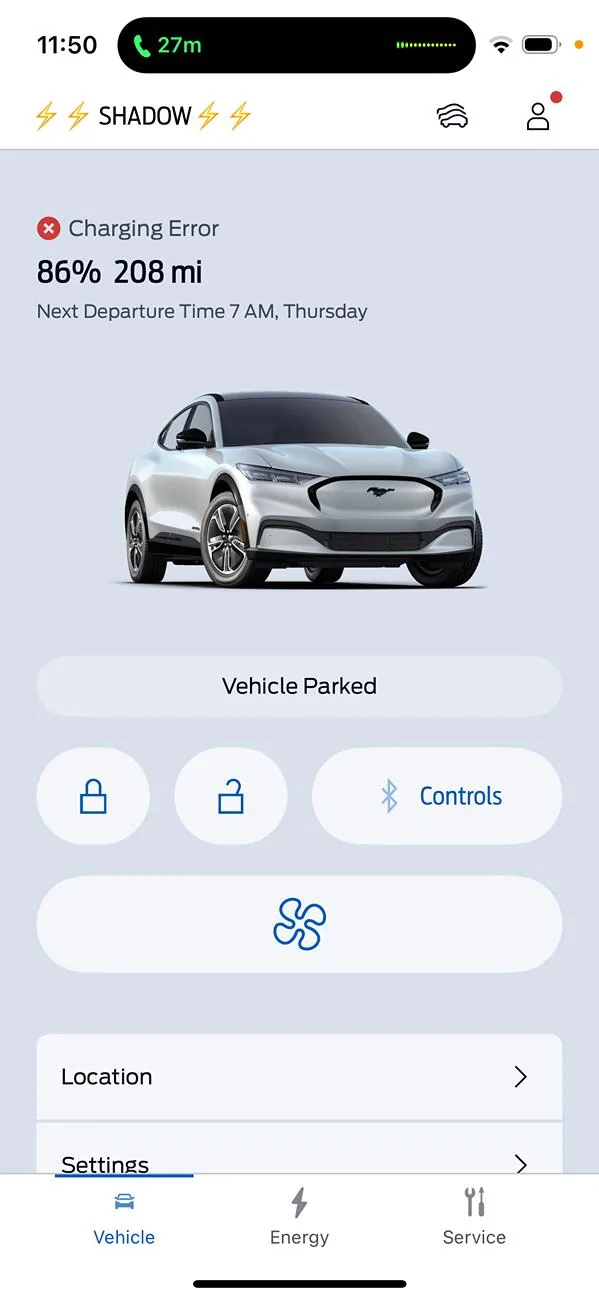

Has anyone had problems with Faulting on Charge Staton Pro? Has message of Charge fault Error on Ford Pass App

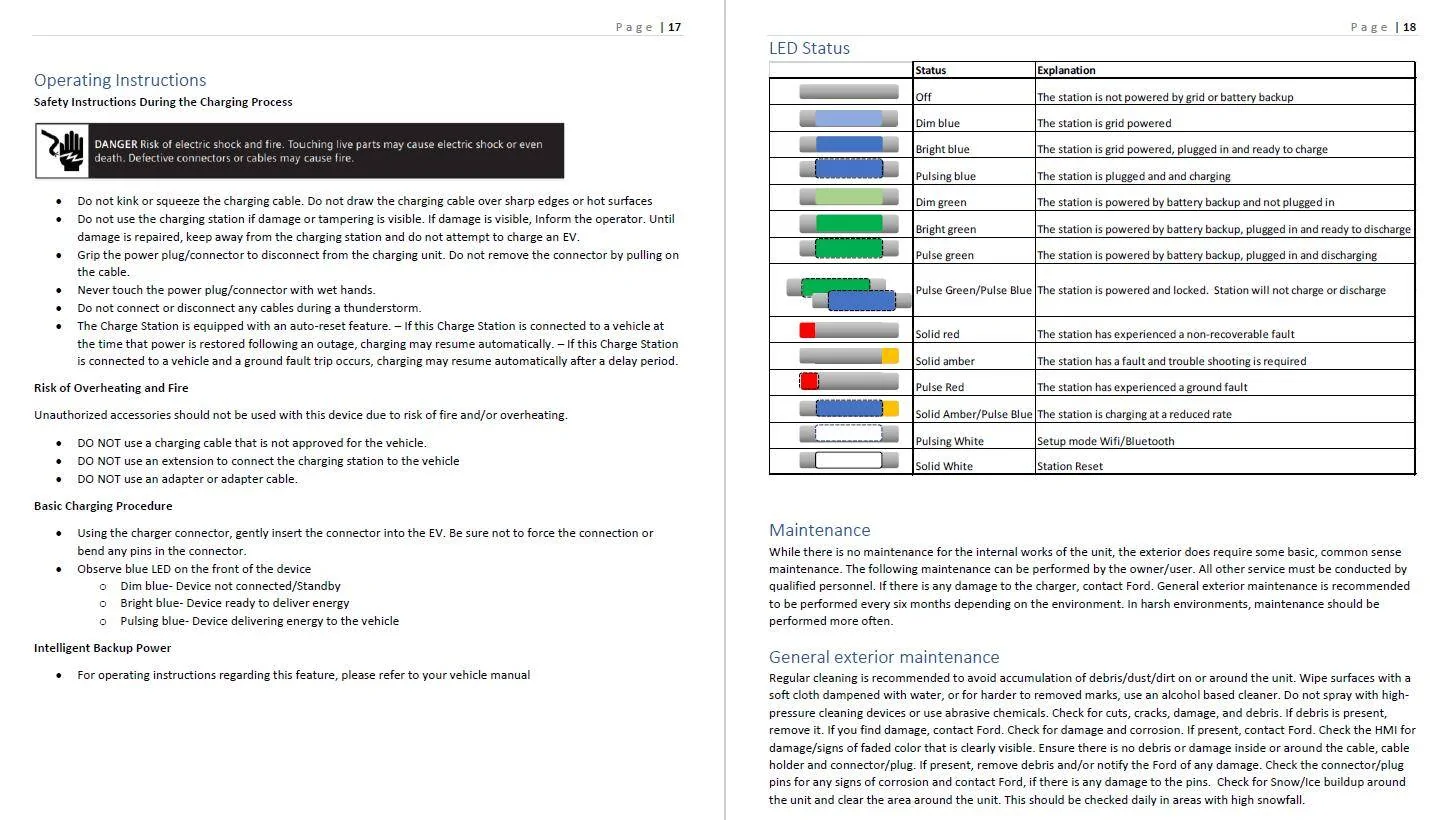

Have you checked which LED color it shows on the charger itself?
I have colors indicating on APP but not on actual Ford Pro Station “Charge Fault”
12,955
17,412
If the EVSE isn't actually reporting an error and the FP app is, it's likely the car encountered a glitch and that's what's being reported in the FP app. Try unplugging, waiting a little bit, and re-plugging. ??
