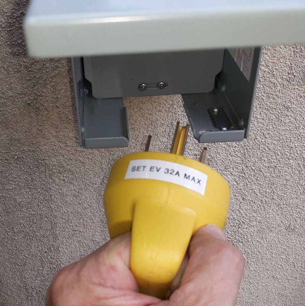

I was lucky that the house I moved into had a full 100A subpanel that was mostly open. I hardwired my ChargePoint Flex. I see about 43mph @ 11kW charge rate set at 48A. The unit cost me $700, but comes with a 14-50 dongle if you want to plug it in and step down the current. The install only cost me $250 in this house because I mounted the EVSE about a foot from the panel.
