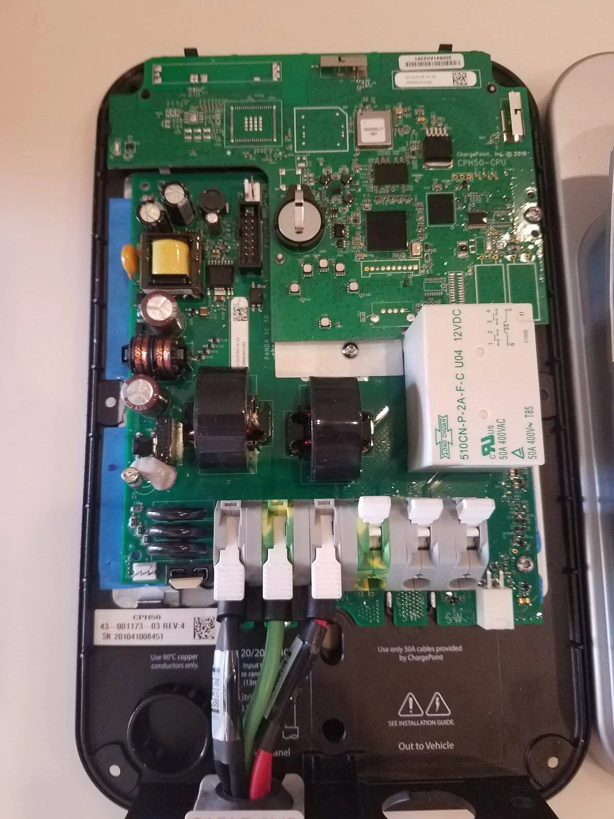

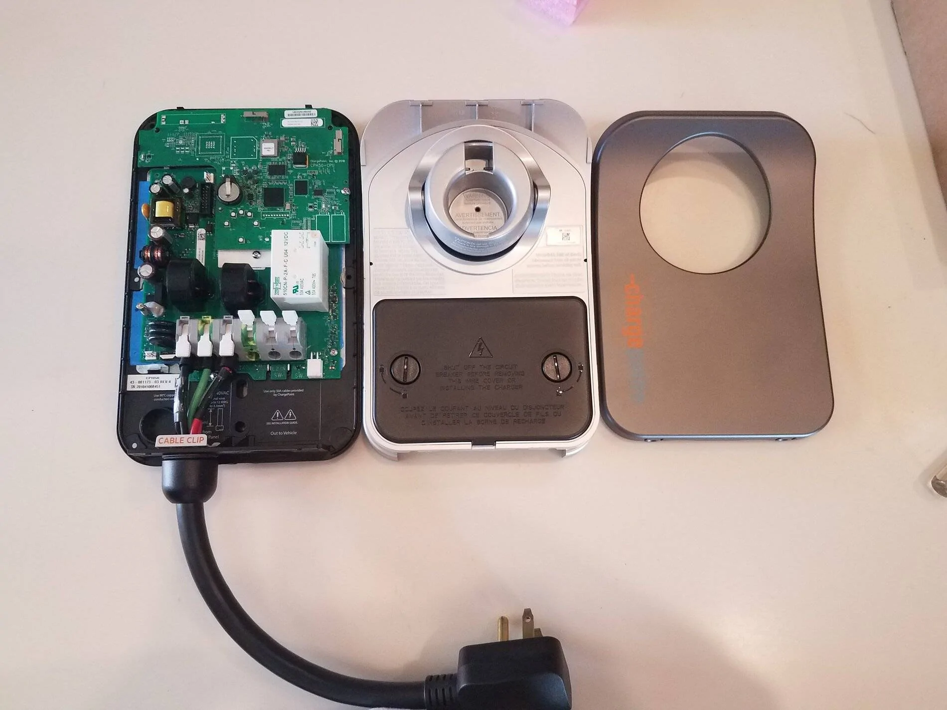

ChargePoint Home Flex $699 (the only top rated 48A charger in stock at the moment)
up to 240V, 50A charge rate, when paired with a 65A circuit
Can be hardwired or NEMA 14-50 Plug configured
- On a 50 amp breaker with the NEMA 14-50 Plug option, this configuration will provide up to 40 amps (9.6kW)
- In order to get 48 amps 11kW+, you need to hardwire to a 70 amp breaker or special order a 65A breaker (50A * 1.25 = 62.5, any breaker over 62.5)
23-foot charging cable SAE J1772 standard plug
