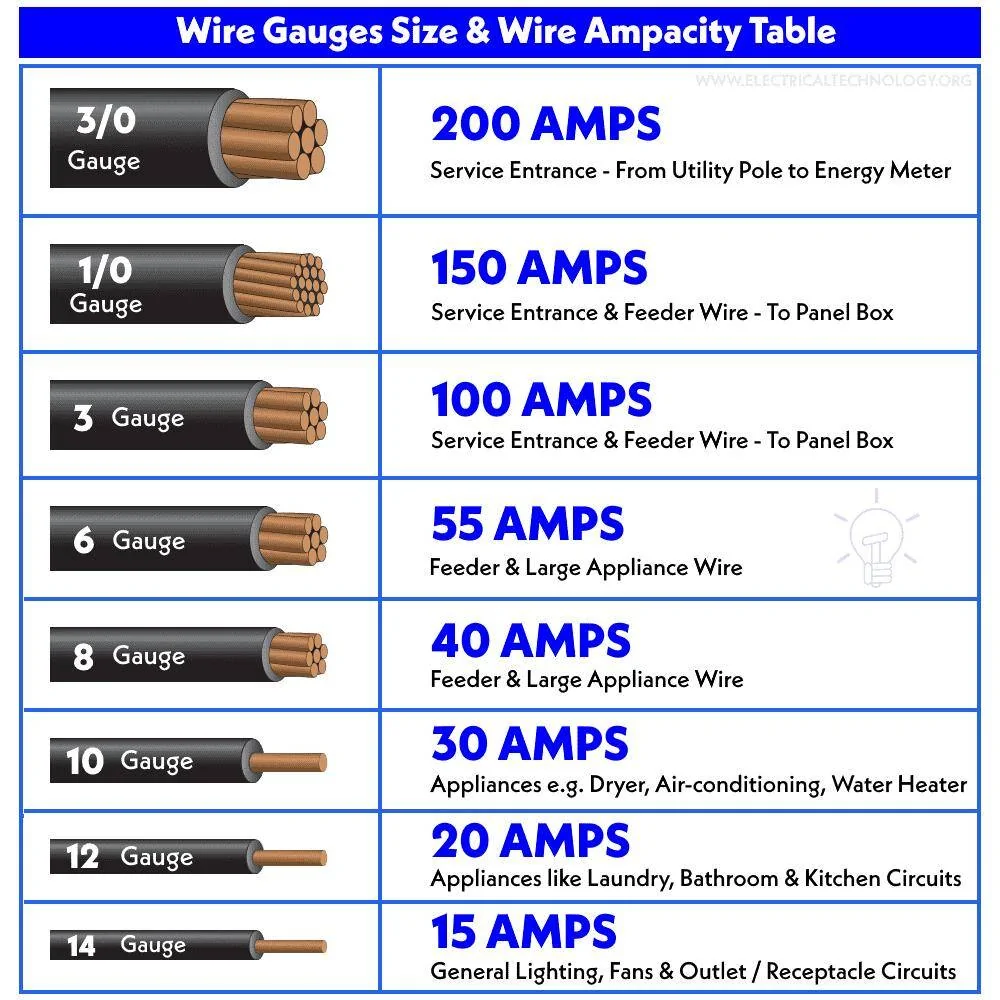

What was the appropriate wire gauge?When my 14-50 was originally installed I opted for the 60A breaker and appropriate wire gauge because I knew I'd eventually go hardwired.

Pretty sure it was 8 AWG copper. But it could have been 6. I don't remember right now.What was the appropriate wire gauge?
