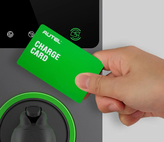

I have an Autel Maxicharger that has an option for RFID card use for restricted use.
Ford Mustang Mach-E Condo Charging autelevchargersresidentialrfid-1648733603266_1200x
Optional RFID for Added Security
Your safety and security are always our highest priorities. With our optional RFID activation and Smartphone app, you can enable card access to prevent unauthorized use and keep your charger secure.
