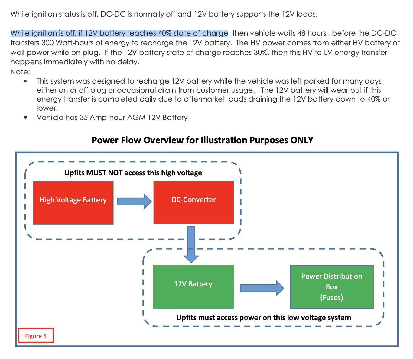

but recently the car has been maintaining the 12v system when NOT plugged in…..
Now wondering if having “SecuriAlert” on all the time, can have a negative effect on 12v system…….
