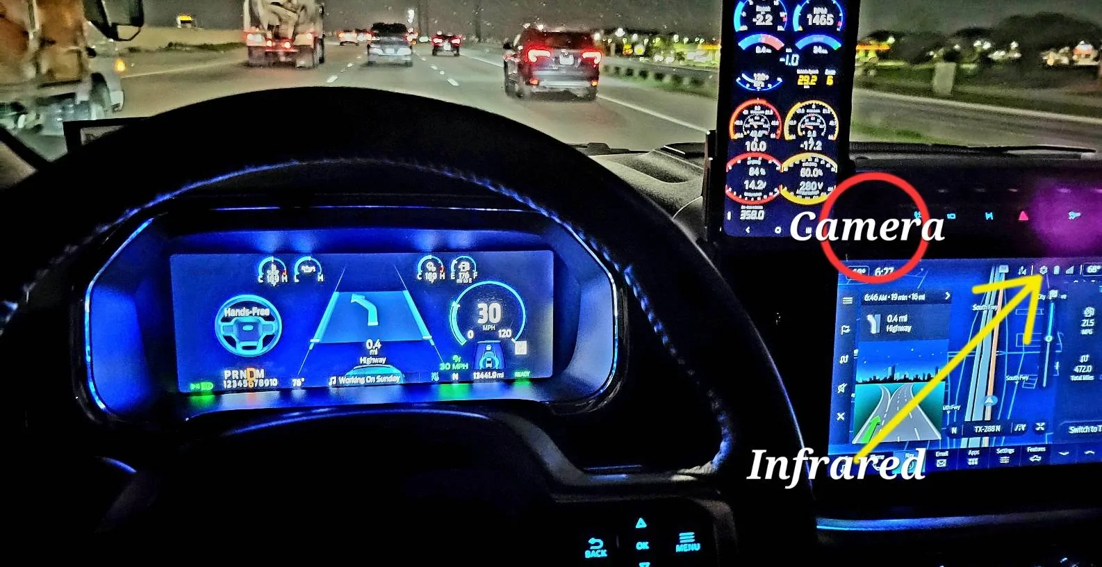

If you use your smartphone camera, it'll pick up the infrared sensor that the eye scanner camera is using to monitor your eyeballs.
Ford uses a different location in the F150 for the eye monitoring components. You can see the infrared sensor at the top of the centerstack in the picture below. And I circled the camera itself.
There is an additional infrared sensor on the A-pillar area on the left side of the driver.
In the Mach-E it appears Ford nestled all of it in that much more compact manner and looking at you through the wheel.
Ford Mustang Mach-E Cruise Control issue - "keep eyes on the road" 20240410_100521
The F150 cabin is obviously huge by comparison. So everything is spread out.
