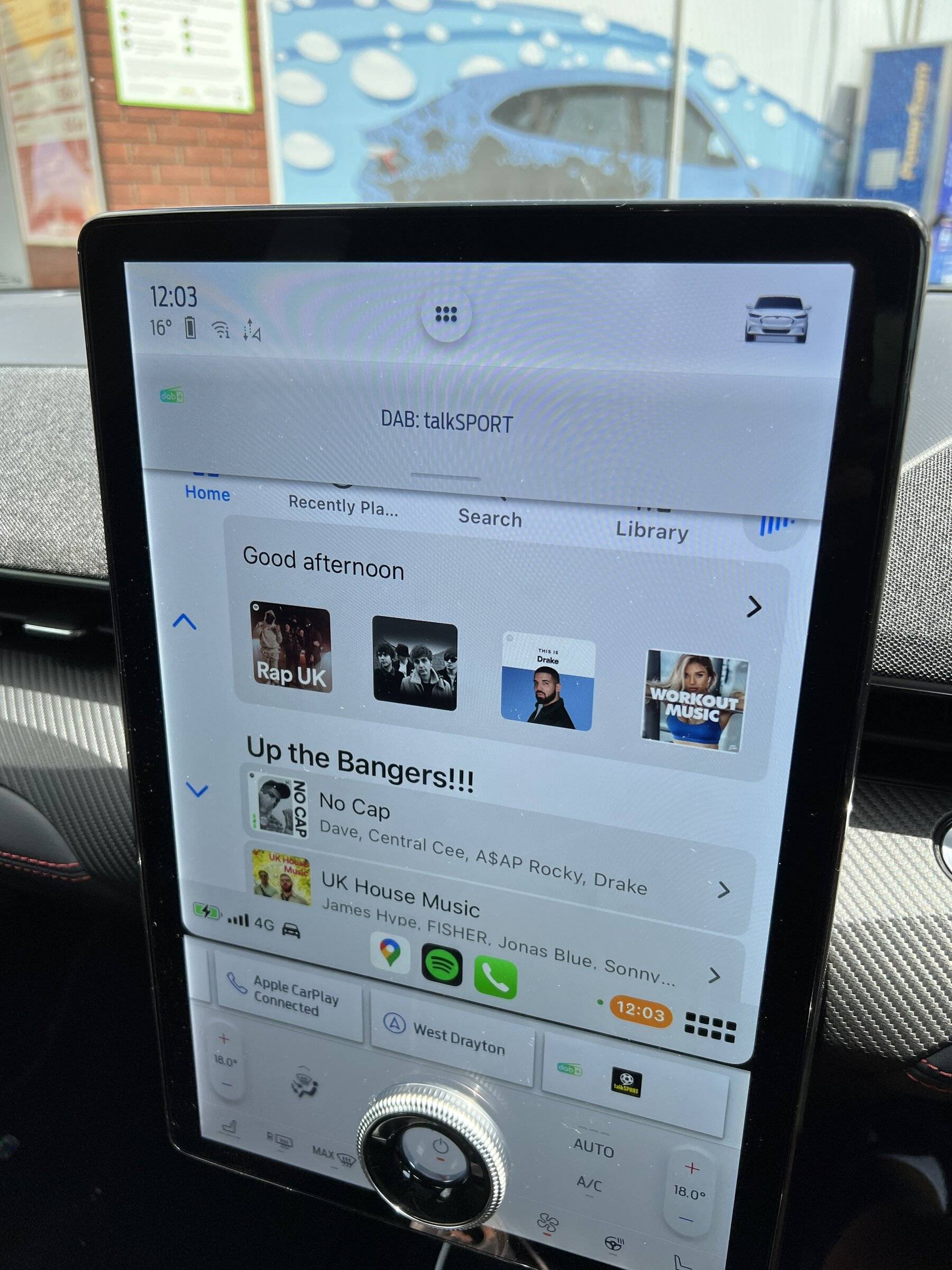

Thanks, I tried it but the message is still popping up. No luck.I have a solution. Comes with a BIG maybe.
I just sold my FE and got my GT. This DAB+ was super annoying. But the one thing that stood out was this “intelligent recommends/ information” when I was setting up the car. You can find again under profile settings.
I disabled, enabled them disabled again. Based on long forgotten posts.
Saved profile using my door button 1 closed the radio by swiping down on it.
haven’t seen it since even if the radio is “on” in the background.

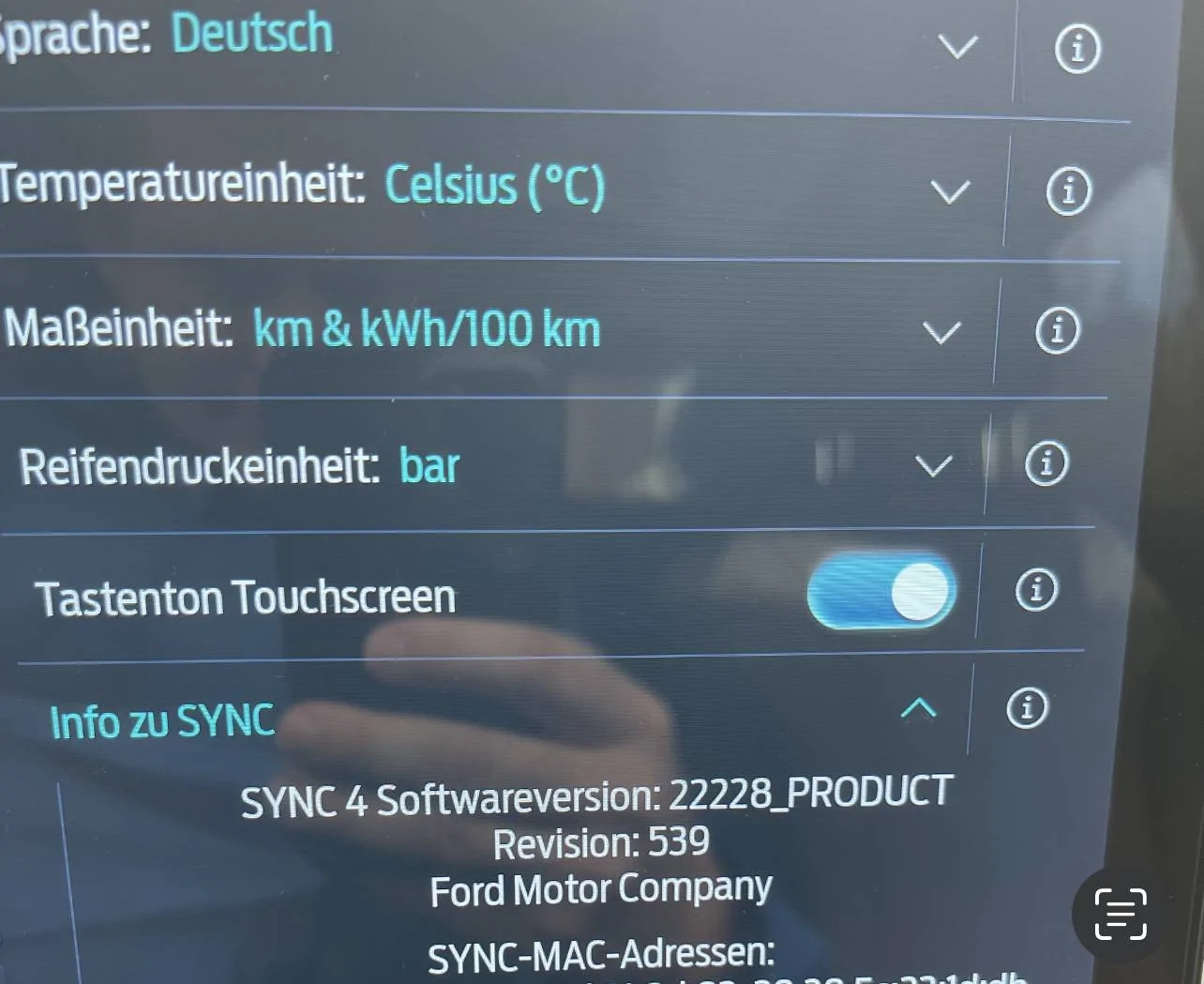

Thanks, that's clear. I also have version 21297 and will have to wait for the updateHello, some cars are also affected in Germany. For us, it is Sync version 21297 and 21355. I was also affected and had version 21297. With this version, the reserve password for starting the car did not work either. Ford raised my Snyc to 22228 in October. Since then, the error in the DAB and password has disappeared.
