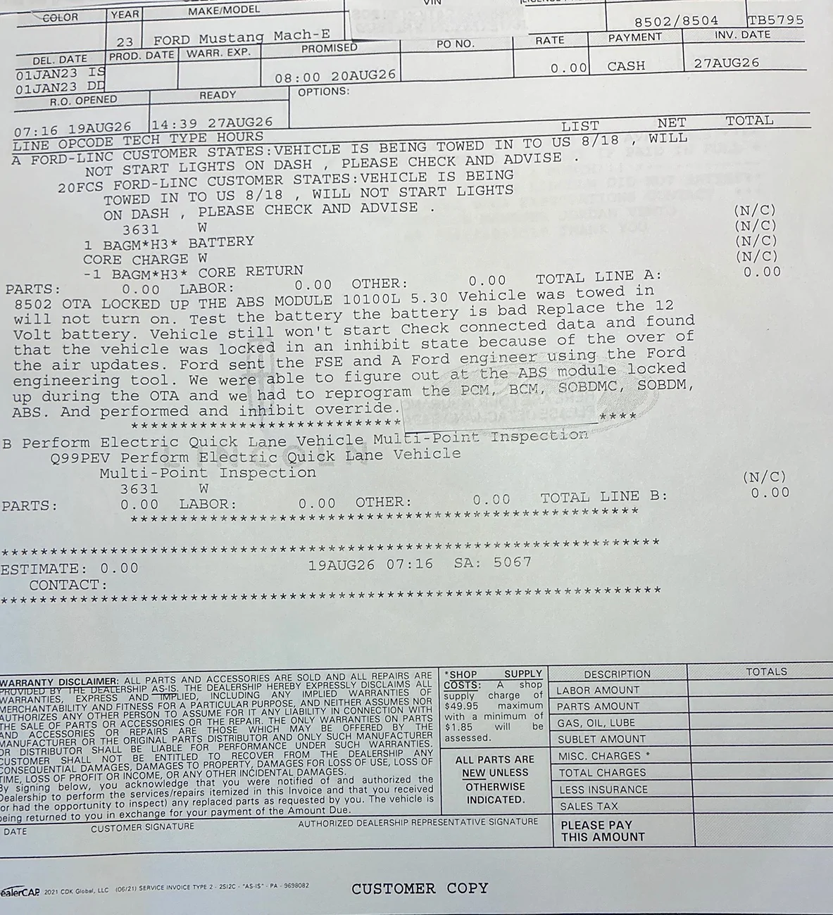

I had an OTA last week and my 23 Mach E 4x is now a brick sitting on the dealers service lot. It was so bad the neutral tow mode will not work.
Every time they do an update I quake with fear. And too, prepare to reset everything.

I had a strange low voltage warning and I checked the small battery and it was good. I then got a little worried about it and took it into my local Ford dealership in San Jose. 2023 mach e 4x They kept the car for 2 weeks and said they were doing updates all that time. They did give me a free loaner which was a Maverick that I drove around. Since that day the car's been fine. It's been about 5 months. The whole update thing and my communication with Ford was a little mysterious. I have no idea what they really did.
This has happened twice to me on my ‘24 Mach-E and both times Ford just acts like it never happens to anyone else. I’ve also turned off auto updates on my car. What happens when it’s out of warranty? I’ll have to pay for their screw up?
