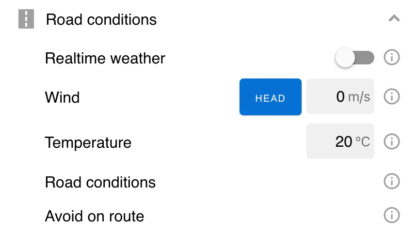

Does the ABRP app take into account the colder weather if one is travelling from warmer starting point to a colder destination? I am planning a trip from FL to Virginia for Turkey week and I have it planned out with ABRP but was curious if it is taking into account the colder temps?

TY, and I would guess it would be in the mobile app as well, somewhere?
That image looks like its a screen capture from the mobile app...so yes (its in your account settings to turn it on).
267
17,939
27,948
No, it does not take into account weather unless you buy the premium version. It clearly tells you this if you try to toggle.
You CAN turn on SEASONAL weatherfor free. Both settings are under Road conditions.
You can also change the reference consumption at 65mph from what it shows to a number lower, like 20%. And, you can change the initial vehicle temp.

TY, I did go premium, so I should be good.
