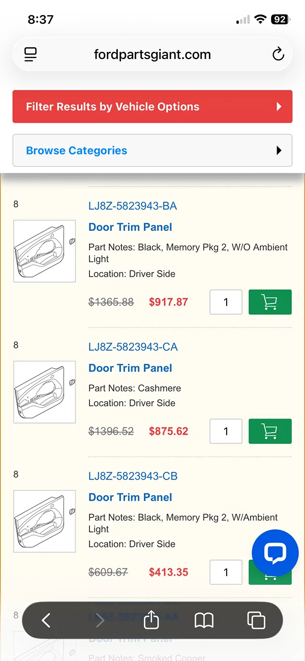

Hey everyone,
What are the differences of the door panels BA and CB? One has ambient lighting and the other doesn’t. Why would the one with ambient lighting be cheaper? Also can either one work for my 2024 select?
Ford Mustang Mach-E Door panel differences? IMG_0059

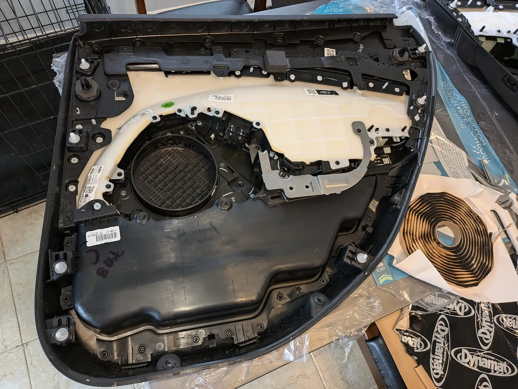

@dolvio you know none of these come with the speaker grille right? All those parts are going to come looking like this -
Ford Mustang Mach-E Door panel differences? 1780844255922-h

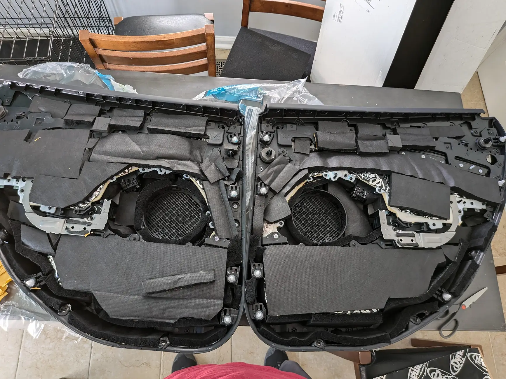

I'm looking at old pictures and trying to figure out if that is riveted or screwed together...if it's riveted transferring the speaker grille over would be a PITA. Including the pics I have just so you are aware of this. It looks like mostly screws but it's hard for me to tell.
Ford Mustang Mach-E Door panel differences? 1780844349209-u6
Ford Mustang Mach-E Door panel differences? 1780844409188-qs
Another consideration for you is that the fabric on the door is held on by the speaker grille panel. I think you'll need a second person to hold the door and stretch that fabric while you tighten the bolts. Otherwise the fabric will be loose on the door.

Great reply and thank you. Yes! I’m just looking for the panel part. I have everything else on my door that I will swap over. The actual speak grill cover is just 4-5 screws. I’m assuming the arm rest and everything else will also be just screws and not plastic welded like the rest of the 3 piece panel. Dumb but whatever.
It’s just odd to me that the higher trim piece is cheaper is all. Every other door panel config is much more money. The one that matches my VIN is $1300 compared to the one for the Premium which is $500. Where is the $800?

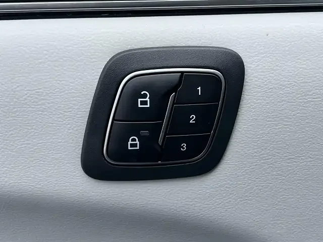

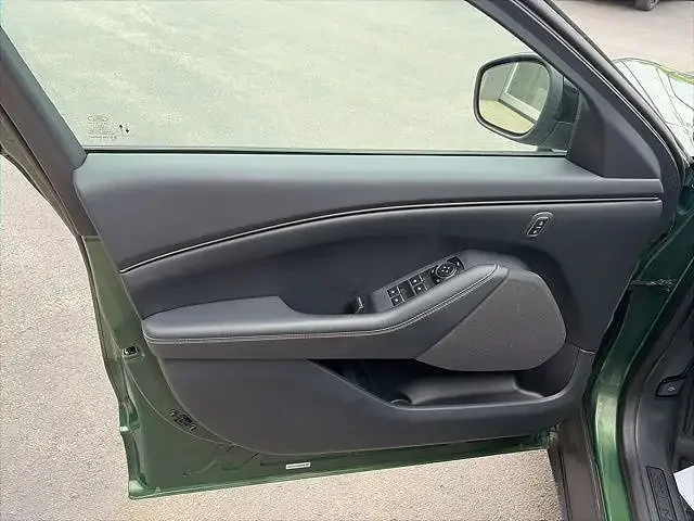

Big difference here, if you don't have memory seats, you'll end up with a big hole...
Select - door locks only (unless you have the comfort or tech package)
Ford Mustang Mach-E Door panel differences? 1780869310884-f1
Premium - has memory seats as well (or optioned Select)
Ford Mustang Mach-E Door panel differences? 1780869467704-71

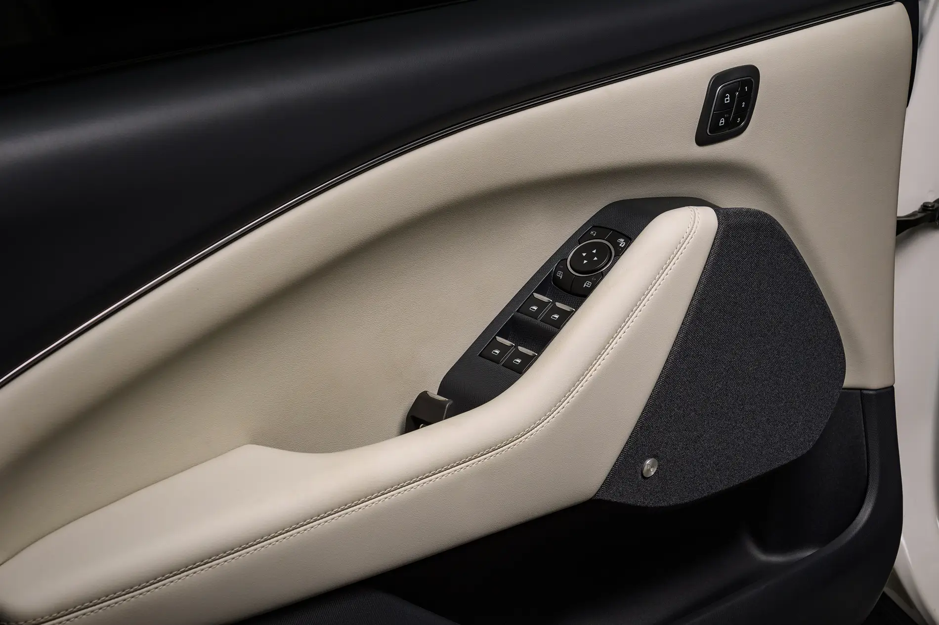

Is it possible one of these door panels is the white/tan colored door?
Ford Mustang Mach-E Door panel differences? 1780926870244-uz
Edit - guess that would be the CA Cashmere one maybe
