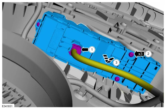

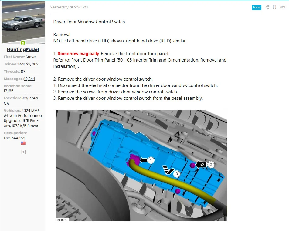

2. Remove the driver door window control switch.
1. Disconnect the electrical connector from the driver door window control switch.
2. Remove the screws from driver door window control switch.
3. Remove the driver door window control switch from the bezel assembly.
Installation
1. To install, reverse the removal procedure.

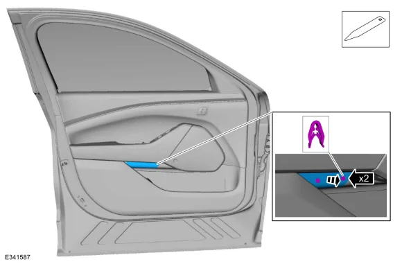

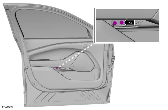

1. Release the clips and remove the front door trim panel upper bolts cover.
Use the General Equipment: Interior Trim Remover
Ford Mustang Mach-E Drivers window switch snapped in half! 1777313527043-bm

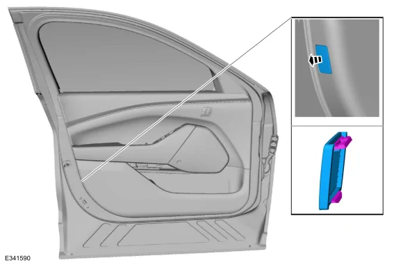

3. Release the tabs and remove the front door trim panel side screw cover.
Use the General Equipment: Pick Hook
Ford Mustang Mach-E Drivers window switch snapped in half! 1777313610167-kx

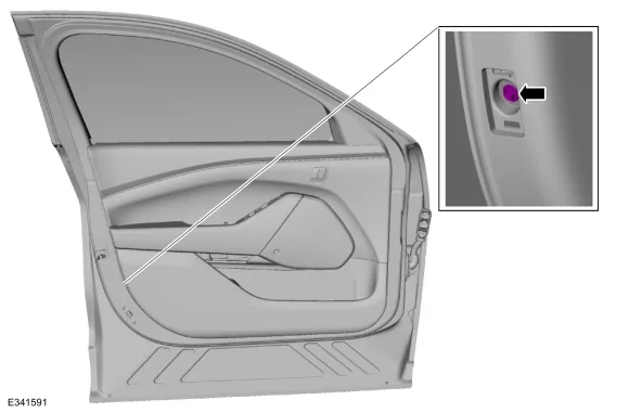

4. Remove the front door trim panel side screw.
Torque : 13 lb.in (1.5 Nm)
Ford Mustang Mach-E Drivers window switch snapped in half! 1777313625526-yj

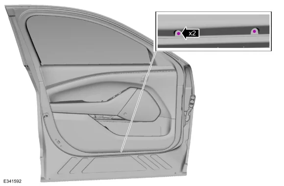

5. Remove the front door trim panel lower bolts.
Ford Mustang Mach-E Drivers window switch snapped in half! 1777313644541-h

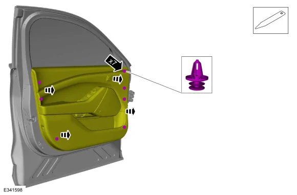

6. Release the front door trim panel clips.
Ford Mustang Mach-E Drivers window switch snapped in half! 1777313749253-or

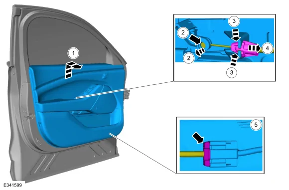

7. Remove the front door trim panel.
1. Lift upward and outward on the front door trim panel.
2. Disconnect the front door interior cable eyelet from the front door interior handle.
3. Release the front door interior cable retaining tabs.
4. Slide the front door interior cable through the opening.
5. Disconnect the front door trim panel electrical connector.
Ford Mustang Mach-E Drivers window switch snapped in half! 1777313793871-ta
