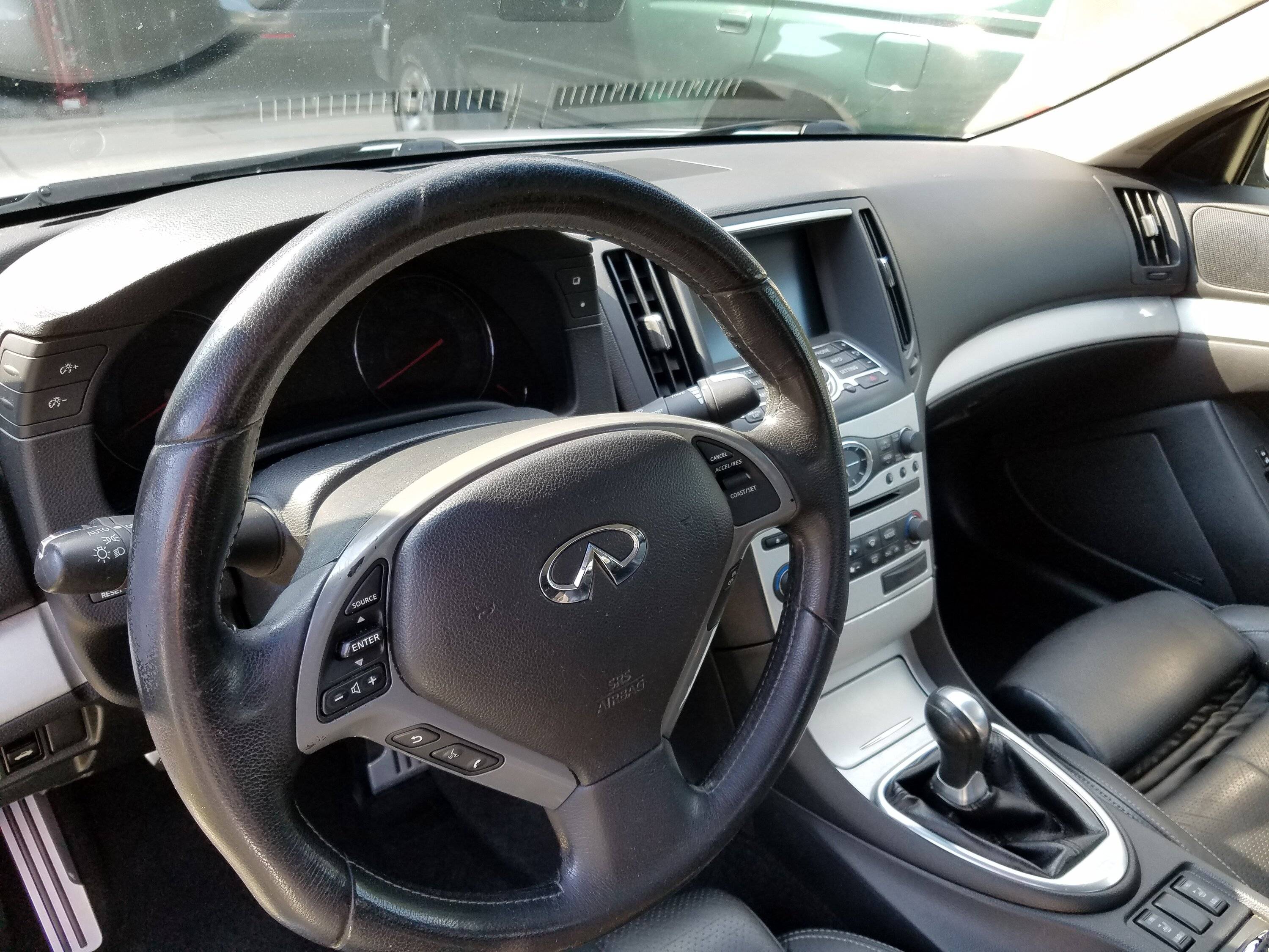

My old Infiniti G35 sedan had a “soft touch“ material on the steering wheel, switches and door handles. Even the slightest touch with a fingernail peeled it off. They changed vendors in later model years and replaced under warranty.
My guess is during COVID and supply chain disruptions, lots of vendor changes for parts happened.
Here is what the Infiniti wheel peeling looked like:
Ford Mustang Mach-E Window switch peeling? IMG_8635
The light grey around the buttons is supposed to be all black. Peeled off like it was Plastidip.
