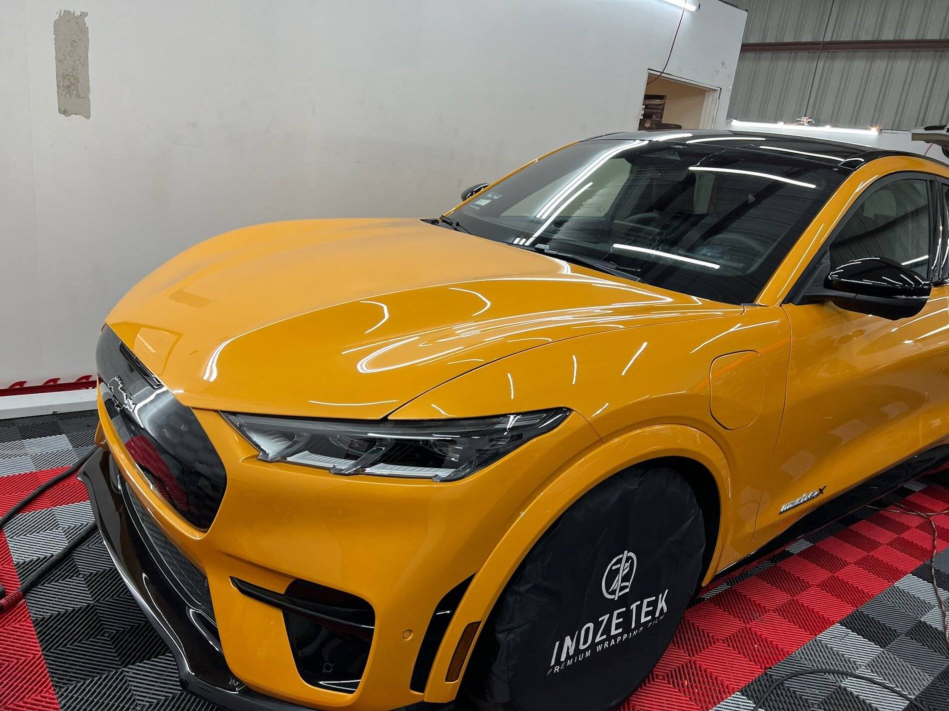

Will find out on Thursday! PPF takes a long time on this car, it's got a lot of surfaces + ceramic cure time
